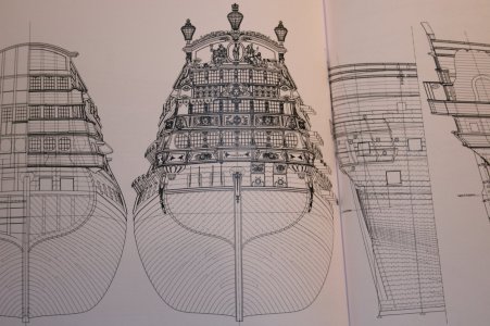

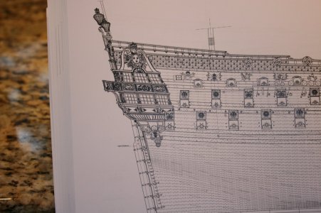

And the only thing I can advise you, if you allow me to do so, is to add a drawing of the aft part of your ship in my first entry in this review to visualize what you plan to do, I've become very curious about what kind of ship it will be.
Thanks for your interest, Sergey. Something like this:

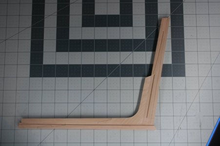

Today's posting will bring this build report up to the current day...

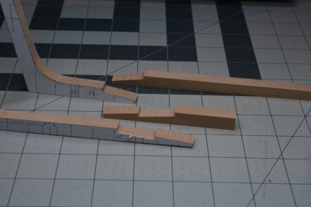

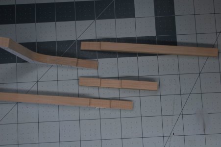

The keel of the SP was of four segments joined in series via hooked scarf joints. Even though I am only building the stern section it happens that one of these hooked scarf joints fell within the scope of my work (I'm building a somewhat longer stern section than more typical examples).
I've made hooked scarfs by hand in the past - but have seen others fabricate them using a mill and a tilting table. I gave that a go...
While I was at it, I also milled a normal scarf into the knee of the sternpost...
An unexpected first-time success!
If you look carefully, you can see that I have also completed some preliminary shaping/tapering of the aft deadwood (and also created the rabbet at the keel and sternpost). The Saint Philippe has a (mostly) square tuck.

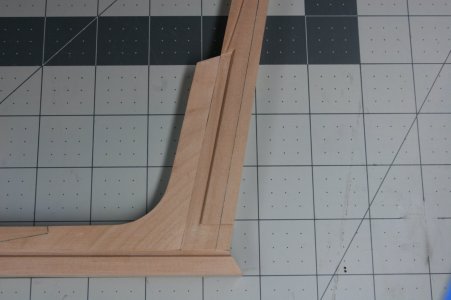

It is interesting to me that the monograph refers to the deadwood (edit - should have said rising wood) as a false keel. I'm not sure if this is a translation issue (my version of the monograph was translated from French) or if there was a different nomenclature in use at that time in history. I also learned that it was a known practice (late 17th century) to add a full keel (not a false keel) to the underside of an existing keel to mitigate hogging.

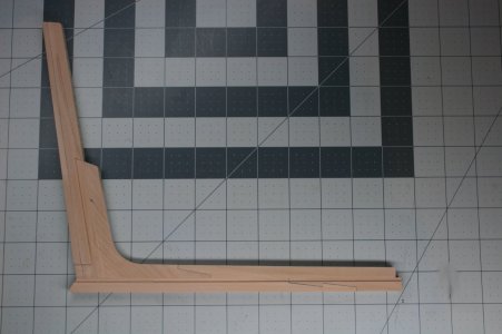

Anyway, here is the other side of the assembly with some of the details visible:

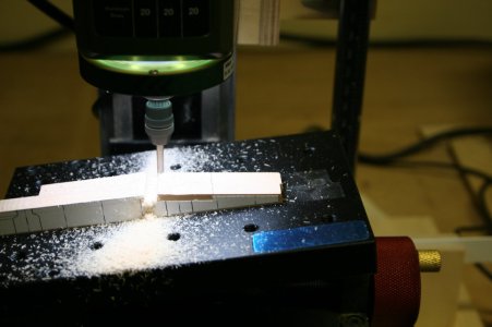

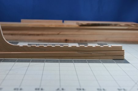

Where the rabbet is straight, I used my little mill. Where the rabbet is curved, I used a v-gouge (very carefully as not to ruin a piece with much already invested in it).

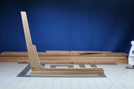

Finally (on the SP), the frames seat into notches along the rising wood. These were cut in with a mill - though there are two that will need to be done by hand because I can't get the mill where it needs to go because the sternpost is in my way).
The following images also show my solution to the fact that the frames are not perpendicular to the keel (they tip forward 1.2 degrees). Under the keel you will notice a 1.2 degree ramp... Now I can erect the frames perpendicular to the build-board and when I remove the ramp I'll have a forward tip to the frames.

I also see that you are using a Proxxon MF70 mill. I just purchased one of those with the ER11 collet upgrade but have not used it yet. What do you think of it? I'd be tempted to say, by the beautiful and crisp looking parts that you've made that you and that mill are getting along just fine! :)
Hello Doc!
That would likely be referred to as 'rising wood'... where the square frames seat into notches atop the keel. Your work is very impressive so far!
Thanks for the terminology tune-up!
I like the MF70 and am glad I am getting to use it. Two grievances: 1. the 'cranks' on the X-Y table and the Z axis need work. I placed thrust bearings on the X-Y table and still need to do the same on the Z axis; 2. I added a digital caliper on the vertical axis but I wish I had a mill with a digital readout. Right now I'm pretty much just eyeballing things but that has its limits.
