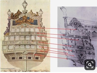

I suppose one could take these plans and build a stern model of the second Soleil Royal of 1693, with the fully closed quarters:
Nobody could argue too strongly that these two views don’t have strong synergy.
Whether or not SR2 had the wing transom still above the stern chase ports, or below as with the SP is anyone’s guess. My inclination, since the ship began on the stocks as the replacement Foudroyant, is that the WT would be below, and in accord with building practices of the Second Marine.

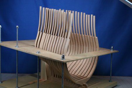

This weekend was spent getting the frames to fit the keel and the jig.
On my Kingfisher build that all just happened without fanfare as a product of the excellent kit design. In the case of this scratch build it required far more fiddling. I ended up needing to remake one (double) frame, and there are a few others I'll be keeping my eye on when the fairing of the hull begins. I also needed to re-do a few of the frame floors - in this case it was more of a patch job than a do-over. If you know where to look the patches are temporarily visible but this will all be covered by planking so eventually no one will know. I'm learning as I go...
As I was fitting each frame in turn, I also removed the paper templates, rubbed off the rubber cement residue, and did some light sanding on the fore and aft faces of the frames. All in all, a surprising amount of work to get to the point that I could take a few pictures:
Obviously, everything is just sitting there loose.
I had the most marvelous epiphany this weekend: a scratch build does not come with instructions ROTF. There are a number of things I COULD do next, but no one to tell me what I SHOULD do next. Clearly, certain things need to happen before anything is glued and before frames can be faired - but my lack of experience is not easily ignored.
With all that said, it is enormously satisfying to look at the above images and know that I started with a few pieces of one-inch-thick lumber :) leaning against my work bench about two months ago.
