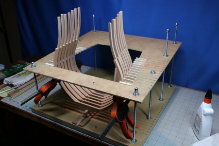

In a moment of confusion/foolishness, I decided it was OK to start glueing up frames.
How long will it be before I figure out this was a mistake ROTF :rolleyes:?

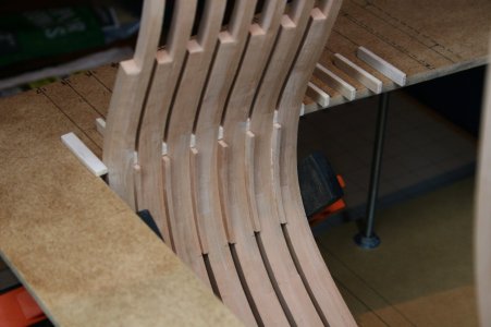

For a ship of considerable size, the SP has rather light framing. There are a number of design features that intend to reduce hogging - and I'm confident the light framing finds its origin in that place. But that leaves this warship vulnerable to cannon fire, so the framing was reinforced along the waterline with fillers:
Earlier I shared an epiphany I had about scratch building: there are no instructions. Making these fillers brought to mind my second epiphany: scratch building requires making everything ROTF. These fillers should have been fast and easy...

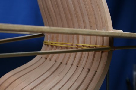

Well, you may be on to something, Maarten. The stern of the ship does indeed sit deeper in the water than the bow (the waterline does not parallel the keel just as you anticipated). But when I measure the frames relative to the waterline now they tip backward...perhaps even a bit more than they tip forward relative to the keel.
As for the building solution...now both you and Nigel have suggested the very same remedy. Consider it done :).

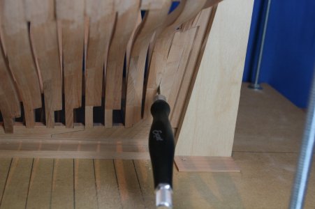

Where the rabbet is straight, I used my little mill. Where the rabbet is curved, I used a v-gouge (very carefully as not to ruin a piece with much already invested in it).
Finally (on the SP), the frames seat into notches along the rising wood. These were cut in with a mill - though there are two that will need to be done by hand because I can't get the mill where it needs to go because the sternpost is in my way).
The following images also show my solution to the fact that the frames are not perpendicular to the keel (they tip forward 1.2 degrees). Under the keel you will notice a 1.2 degree ramp... Now I can erect the frames perpendicular to the build-board and when I remove the ramp I'll have a forward tip to the frames.
