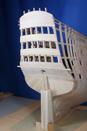

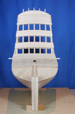

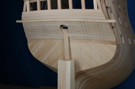

Attention this week turned to the stern planking. The lower half where you see pencil lines will remain visible - iron nails are pending. The upper half (which frames the three rows of lights / windows) will all be covered by decorative carvings or decorative panels. I will not bother to nail this upper half - and I also made no attempt to keep the planks a consistent width in this area.
The diagonal planks of the square tuck have been trimmed for length. That rest of the stern planking has not been trimmed yet. I have also (uncharacteristically) resisted the urge to sand these stern planks at this stage of development.
Nothing too fancy here. I was just trying to do clean work...

Thanks, Wojtas. Not so easy to bend those strakes and get them to fit...

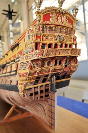

Anyway, I am only aware of several completed Saint Philippe models. Here is the stern section from Michel Margerotte's attempt:
I don't think I will be painting my model so it will have a completely different feel. While not as ornate as Soleil Royal (she was the flagship of the Admiral) I face an uphill battle in creating the decorations and carvings...
