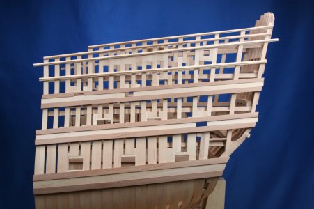

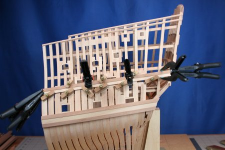

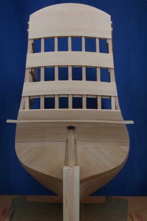

Before turning my attention to the wales and hull planking it was necessary to clean up the stern facade:
The lower portion remains unfinished. I'm waiting for some square copper wire to arrive and then I'll need to conduct some nailing trials.
In the meantime, I profiled an additional rail(s) - the larger of these is technically the uppermost wale:

Some very nice profiled rails, Paul. They lined-up the top of the frames very well.
Thanks, Peter. The European pear wood is really very nice to work with. It is a wee bit softer than the Castello Boxwood I used on the Kingfisher but not too much (I say this while in the middle of trying to sand the upper counter smooth and it is fighting me the whole way).

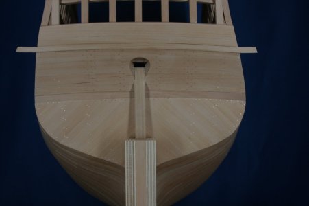

Hello Friends!

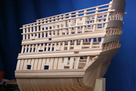

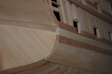

I dedicated my modeling time this week/weekend to wrapping up the stern planking along with the installation of the seven wales (and a third upperworks rail).

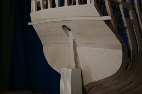

The stern planks are attached with square nails on the SP. I have limited these to the lower half of the stern - the upper half will be largely covered with carvings and decorative panels so I have omitted the nails for now (but may discover that some are needed...).
Here is the stern facade:

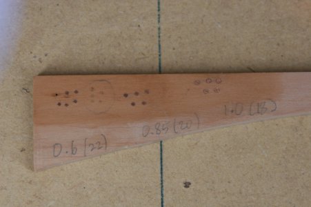

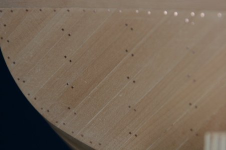

The nails are copper and have not been 'blackened' at this point. Casey's Brass Black does a great job burnishing copper but can stain the wood. A possible workaround is to seal the wood first though I have only 'seen' this and have never attempted it myself. Liver of Sulfur can also burnish copper and reportedly does not stain the neighboring wood. I did a trial but was not entirely pleased with the results:
It's not bad, but there is in fact some mild staining of the wood that I thought caused the square nails to become less well defined... On the Kingfisher I am simply leaving the copper to oxidize/tarnish naturally. I will continue my research and trials for the SP.

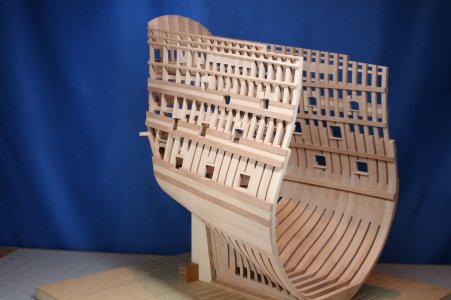

Here are the wales:
I have started to rethink how much of the lower hull will be planked.
Thanks for stopping by to see what I have been up too!

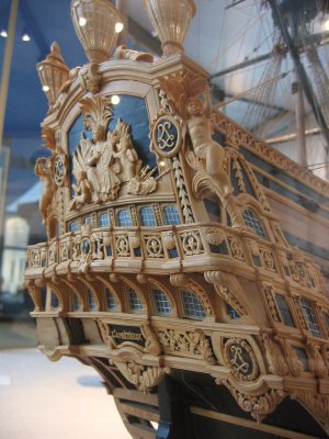

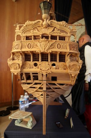

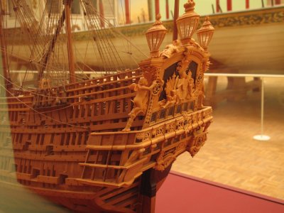

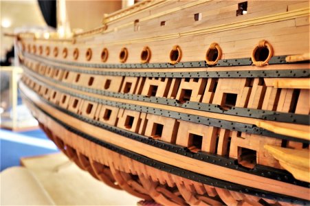

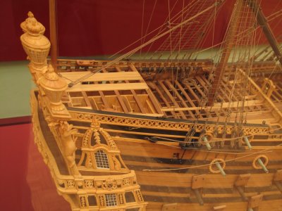

Hi Paul
I can post you some models for inspiration. Most classic would be planking only half excluding only wales, but other options are also worth considering.
I guess other Saint Philippe you've already seen
Le Protecteur
Bernard's Frolich L'Ambitieux​
Michael Saunier's half cut ribs Solei Royal
Le Fleuron 1/24 Jacques Mailliere
Hello Friends!
It's not bad, but there is in fact some mild staining of the wood that I thought caused the square nails to become less well defined... On the Kingfisher I am simply leaving the copper to tarnish naturally. I will continue my research and trials for the SP.
Here are the wales:

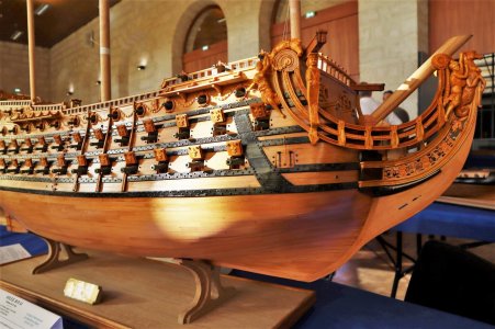

Hi Paul
Le Protecteur
Michel Saunier's half cut ribs Solei Royal
Hi Wojtas - at least your examples don't set the bar too high ROTF.
Looks really nice Paul - I would just let the copper wire tarnish in situation as it will. More focus will be on your beautiful woodwork and the carvings !
I haven't taken a close look at my Kingfisher recently to see how the copper bolts there have oxidized - but right now I'm inclined to agree with your suggestion. Keeps things nice and clean and not too prominent...

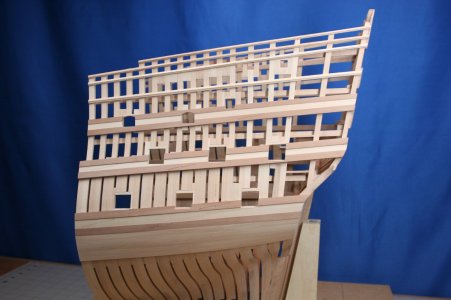

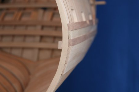

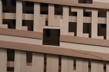

Work in progress...
I have now added five rows of hull planks below the lowest wale. These strakes become progressively thinner as they approach the lower hull - something ordinarily not really observable on a ship model but clearly visible on a section model.
I'm thinking about leaving the rest of the lower hull exposed which is a significant change from my original vision for this model. If so, I will need to retrofit some chocks that sit at the base of each frame pair in relation to the keel (not installed previously because they would not be seen).
I also re-opened gun ports - an exercise that will need to happen again when the balance of the planks are installed (I suppose I could do this all at the end of planking but it makes me nervous to lose my visual cues re: frame edges).
Onward...
