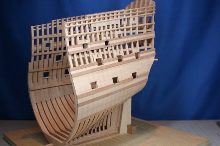

I have now added five rows of hull planks below the lowest wale. These strakes become progressively thinner as they approach the lower hull - something ordinarily not really observable on a ship model but clearly visible on a section model.
I'm thinking about leaving the rest of the lower hull exposed which is a significant change from my original vision for this model. If so, I will need to retrofit some chocks that sit at the base of each frame pair in relation to the keel (not installed previously because they would not be seen).
I also re-opened gun ports - an exercise that will need to happen again when the balance of the planks are installed (I suppose I could do this all at the end of planking but it makes me nervous to lose my visual cues re: frame edges).
Onward...
The different types of wood looks great, Paul. And for the overall looks …… What can a say …….
…… Perhaps a quote: ‘I believe the word is gob-smacked. Just...WOW!’

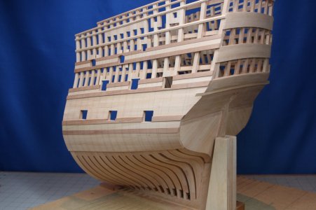

Work in progress #2...
Modeling time remains in short supply and the forecast for the short term is for more of the same. I have completed the planking in between the two lower wale pairs (in association with the lower gun ports) and irregularities between these strakes have been leveled (final sanding after nailing):
Thanks for the visit!

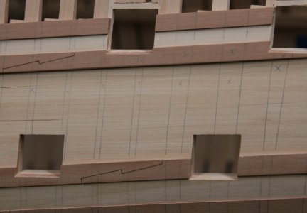

That’s looking very nice, Paul. A fine base for the nailing and final sanding.

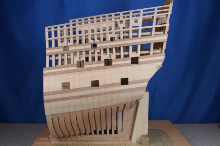

I had no doubt whatever finish you choose it will be perfectly executed
Thank you, Peter. The pear is very nice to work with.
Thanks, Wojtas - I've been ignoring the subject of finish for the time being but I do appreciate your confidence!
Very clean work Paul.
Thanks you kindly, Maarten.
