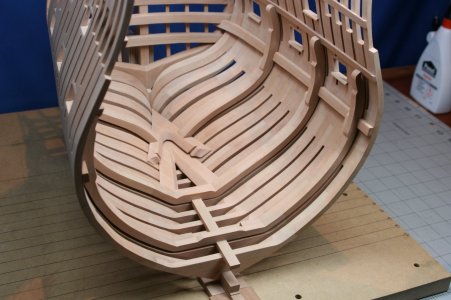

Hello Friends,
As I continue to explore wood finishing options (translation: throwing good money after bad) work continues on the Saint Philippe stern section model.
I have now emotionally committed to working on the exterior hull planking as my next major effort (translation: kicking the can down the road on the wood finishing decision). But I had already begun work on the rider frames and flat crotches so I thought it would be best to wrap those up before starting something new (translation: if I don't finish these now, I'll forget how to do what I am doing).
Here is where I am at the conclusion of the weekend:
I'm sure you noticed the gap between the rider frames and hull framing. This is intentional. The rider frames actually sit on the ceiling strakes - but I'm not installing ceiling strakes - thus the gap.
I had hoped to show you one more rider frame (actually, two half rider frames) that sit on the upper flat crotch. Unfortunately, while working on these half frames, I cut the fairing bevel in the wrong direction. Double unfortunately, I have now used up the pearwood panels needed for the frames (6.2 mm thick) so I am back to being a woodworker instead of a modeler. Not a major set-back, but still frustrating.
Thanks for stopping by!

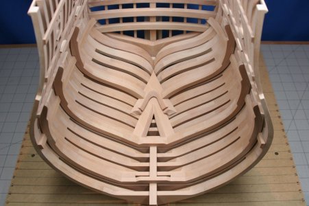

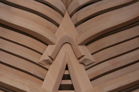

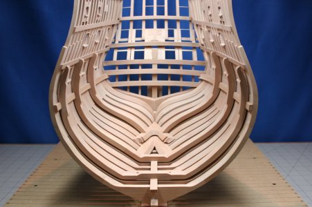

I had the day off today, so there was bonus time in the shipyard.
This now brings the previously aborted fabrication of rider frames and flat crotches to a satisfying conclusion (notwithstanding the part where I sanded off a little bit of my finger :oops:).
Everything is just sitting there loose and will now be removed to a safe place pending final installation.
Next up: back to the monograph to research stern planking along with the wales and hull planking.
