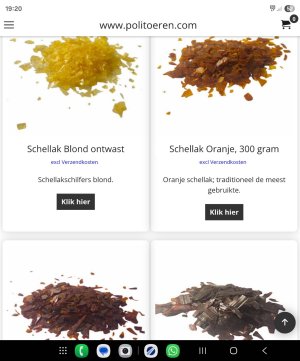

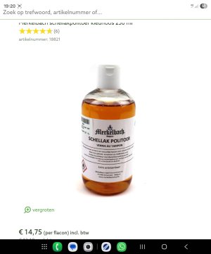

Hi Paul,
I use schellac politoer, which is premixed with alcohol and therefore easy to use.
If you use multiple layer it will give a shiny surface as at dockyard models. With a single layer it will mainly absorb into the wood and creates a matt-satin finish. To create a fully mat surface you can lightly sand it with some steelwool after the treatment.
You even have different colors of shellac.

Shellac is also available in dry form on Aliexpress :cool: Alien

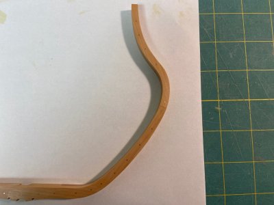

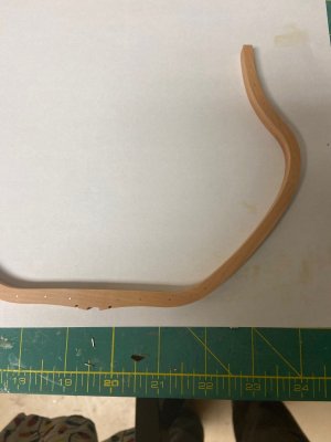

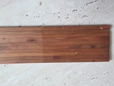

I ran a test the new amber shellac flakes than arrived recently on one of the reject frames (there are many) for Fame. Here are the results.
First pic - one coat of 1lb cut - almost looks unfinished - very flat and the wood is sealed.
Third pic - three coats 1lb cut - has a nice luster. Each additional coat will add more gloss and deepen the finish as desired. In this test I also applied a thin coat of wax as a top coat.
Thin coats dry superfast - less than 30 minutes - and its sands easily to ensure future adhesion (one of the major reasons I will be using it as I will be applying finish to hard to reach areas as I continue to add assemblies onto the model). Also its easy to repair scratches - just add a little more shellac to the area and they vanish.
Link to the shellac you're using?
Witaj

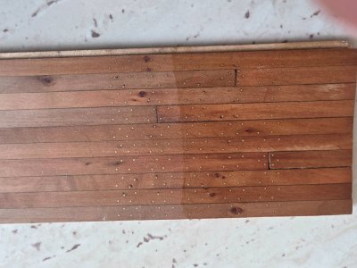

Mam probki gruszy pokrytej olejem i szelakiem na pierwszym zdjęciu olej tungowy dwie warstwy ijasny szelak na drugim olej lniany dwie warstwy i szelak jasny olej kładłem 2 miesiące temu a szelak1 warstwa miesiac. Pozdrawiam Mirek

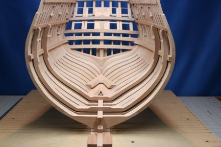

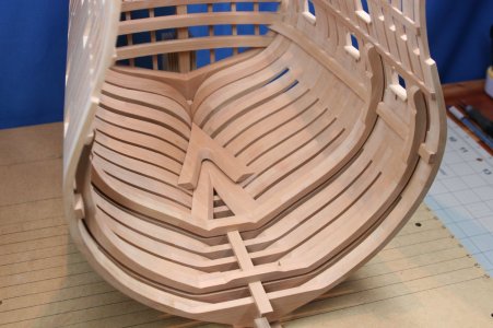

I have now emotionally committed to working on the exterior hull planking as my next major effort (translation: kicking the can down the road on the wood finishing decision). But I had already begun work on the rider frames and flat crotches so I thought it would be best to wrap those up before starting something new (translation: if I don't finish these now, I'll forget how to do what I am doing).
Here is where I am at the conclusion of the weekend:
I'm sure you noticed the gap between the rider frames and hull framing. This is intentional. The rider frames actually sit on the ceiling strakes - but I'm not installing ceiling strakes - thus the gap.
I had hoped to show you one more rider frame (actually, two half rider frames) that sit on the upper flat crotch. Unfortunately, while working on these half frames, I cut the fairing bevel in the wrong direction. Double unfortunately, I have now used up the pearwood panels needed for the frames (6.2 mm thick) so I am back to being a woodworker instead of a modeler. Not a major set-back, but still frustrating.
