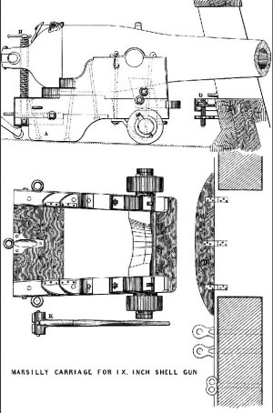

In my opinion, the lower portion of the sill should not be used or designed as a bumper, as doing so would inherently weaken the structural integrity of the gunport sill. Additionally, if you refer to the carriage design used by the Continental Navy (?}, you’ll see that the bumper is positioned at the front of the carriage itself, not integrated into the sill. However, there is a 'bumper' below the gunport attached and reinforced with metal plates.
or this

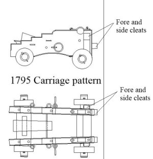

Thanks Jimsky. Not too different than the English with the first orders coming out 30 September 1795. The breast ended preventer cleated carriages are later described by Congreves in 1811 and are shown in a later painting, Death of Nelson by Irish artist Daniel Maclise. As an aside, this painting is full of great information including women on board during Trafalgar which I never knew until recently and should be of interest to anyone building Victory.
Yes, Alan, I agree. However, the schematic top (side) view appears to differ from the lower top view. I don’t see the “bumper” indicated there. Perhaps I’m simply misinterpreting the drawing.
