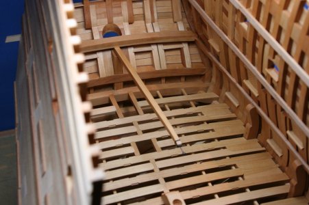

Ledges for the 2nd deck:

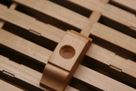

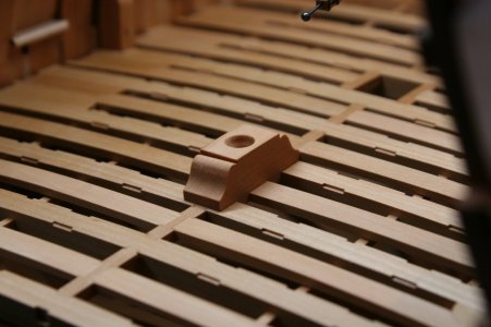

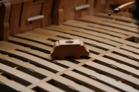

The mizzenmast step:
An out-of-focus picture of a tiller:

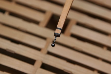

The working end of the tiller:

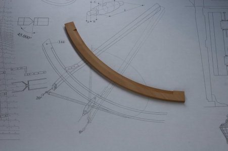

I still need to add a shoe that will engage with the tiller sweep (pictured below with a drawing):
The tiller sweep will be mounted to the underside of the beams of the second deck. This means the sweep shown above has a round-up that matches the round-up of the beams of the second deck. It will all make more sense later. Or not :rolleyes:.

Great pictures and the rudder focus was perfect (on the aft half) ROTF . The closeup of the tip made up for that photo!

Thanks, Brad. But the only milled aspect was the underside of the mast step. No mills were harmed in the fabrication of the other parts ROTF.
