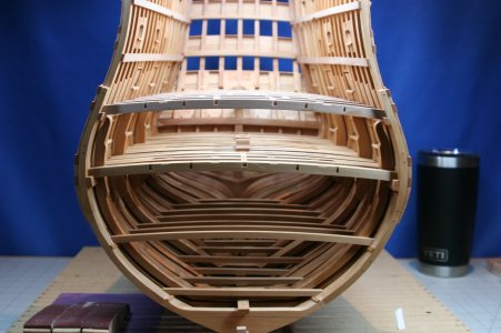

Work continues on the second deck. Beams were fitted to the deck clamps and the layout for the various mortices was completed:

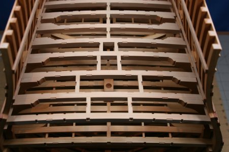

Below you can see the tiller sweep and the boot that rides on it. I mentioned earlier that this tiller sweep has a round-up that matches the second deck beams. At this point these components are just sitting loose but they will need to be installed at the same time as the beams as it will be difficult to add them later.
And now a few of the centerline carlings and coamings have been installed on the morticed beams - the joinery is via dovetails.

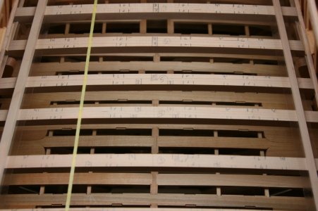

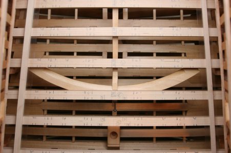

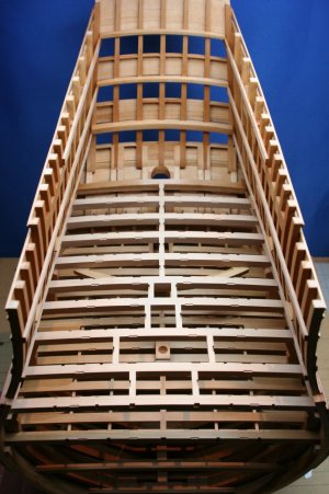

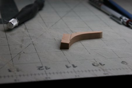

My attention now turned to the (hanging) knees. The knees on the second deck are more difficult to fabricate than those associated with the first deck - half of them are angled to avoid gun ports - and the tolerances to the ledges (installed later) are uncomfortably tight. Here is a knee beginning its journey:

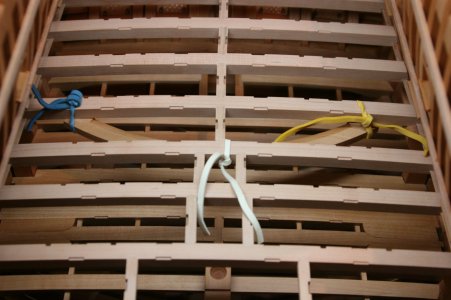

Of course, while fitting the knees, I carelessly broke off the tiller sweep. Turns out I don't have any clamps that are useful for this 'late-in-the-game' mishap; so, we make do...

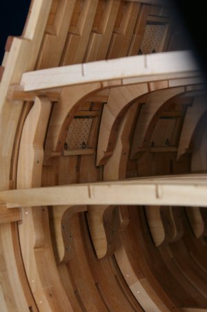

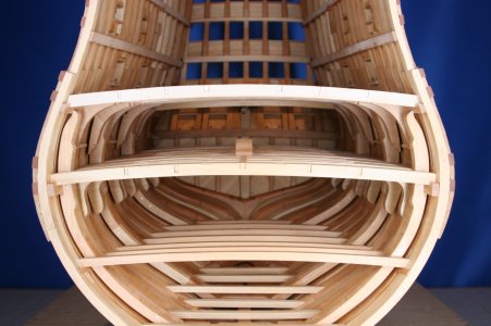

Just for you guys :) - here are the freshly installed knees:

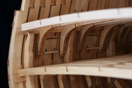

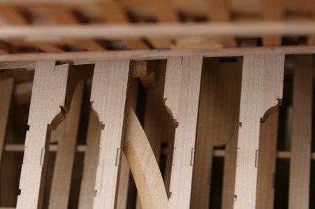

As you can see, the knees on the second deck have decorative ends:
Including on the vertical elements:

That tiller sweep looks so smooth and functional!!! Even with rubber bands holding it in place!
