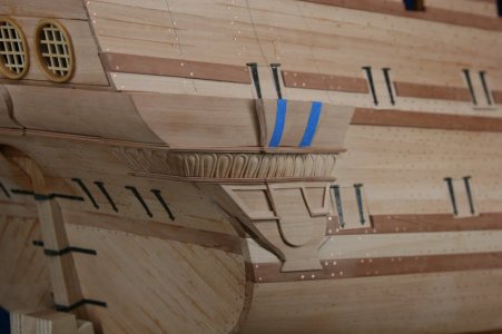

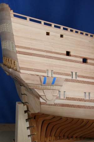

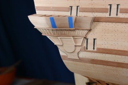

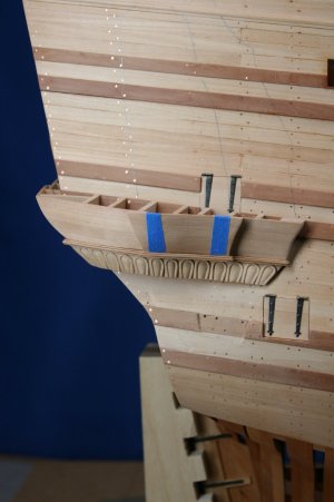

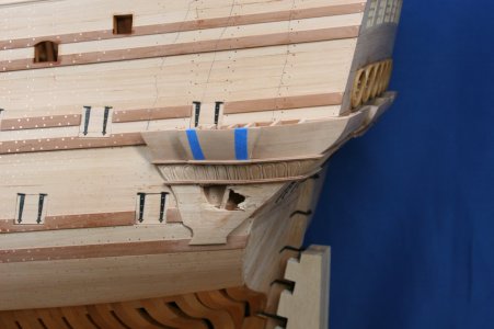

Work has continued on the lower portion of the quarter galleries. I confess that I am really struggling with alignment issues. The question has been asked: press on or start over???
I am going to step away for a few days and see how I feel after a little break.

It’s a impressive puzzle, Paul. And for sure it’s difficult to let it look fine, with all the curves, from all the different angles.
A good idea to take a brake and enjoy your Father’s Day.
Hmmm I think the addition of the new parts look fine - what throws me a bit is the level with the carving and the molding - that throws everything a bit off balance. Not as much on the starboard side. Looking at it again the carving's images need to follow the over all flow of the galleries a bit more - meaning - the "horseshoes lean forward at the front of the structure, stay vertical in the center between the blue tape, then lean a bit backward as it approaches the stern.
It such a complex shape - you will get there - step away and enjoy Fathers Day.

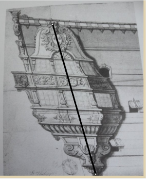

My problem is I am more of a craftsman than an artist so I'm not entirely sure what I am not seeing/doing. As I want my next attempt to also be my last attempt I could use some help. I think where my first attempt got off the tracks was there were too many lines vertically.
The top half seems fine - but the bottom half is wrong.
Is that what you see as the problem as well?
As an 'attachment' see the drawing from the monograph (I'll necessarily delete this in a day or so). The vertical red line appears to be the controlling line. But then each of the structures circled in yellow are 'skewed' - or is that because I am looking at a 2D depiction of a 3D structure?
Having asked that, the very top portion is mostly flat relative to the hull, so it seems the drawing shows the actual anatomy - at least there???

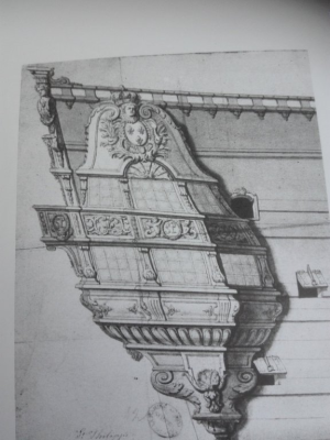

The image Maarten posted shows a bit less skewing, but close:
My thanks.

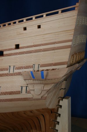

I’d actually build a prototype first. I’d start with a 2D drawing, print it out, stick it onto cardboard and adjust it to the hull until it sits harmoniously on it. Then I’d work my way up and down from the centre by adding layers of cardboard; there’s also architectural cardboard available, which is a bit thicker. You can then work on it from all sides and transform the 2D design into 3D. Towards the end, you might use modelling clay to refine the shapes. Once everything fits, recreate the individual segments in wood and keep fitting them to the prototype; the prototype can then gradually be incorporated into the wooden structure. But as I said, that’s probably what I’d do – I don’t know if it’s the best way.
Hi Paul,
What I would do is make the lower panel first without the carvings.
Than dry fit it the the gallery.
At the top of the panel devide the number of carvings needed just by simple pencil strokes/dots.
Now these dots you connect with ruler to the lowest point of the gallery as these lines should coverge to this point. Now draw the lines at these angles across the panel. This should result in a panel with lines giving you the orientation of your carvings. Now you can simply draw the carvings radii and start carving.
Hope this helps.
Yup, the same problem of a 2D drawing that's actually a 3D form. the way Maarten discribes is a good solution to solve the problem.
I think the part left of the red line and the part on the right are almost equal, the same . Only the right is draw under an angle. It's a difficult thing for a brain to see the 3D shape in a 2D drawing. You need to train that by drawing 3D shapes. For example, draw a circle in a sqare on paper, devide it vertical with a line. Then make a fold along that vertical line and fold that part back. Now look to the left part and see what the right part does when you fold that back. That part will get narrow like the drawing you use. Where the fold possible is between window 2 and 3. Hope that helps.

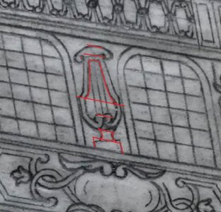

My thanks.

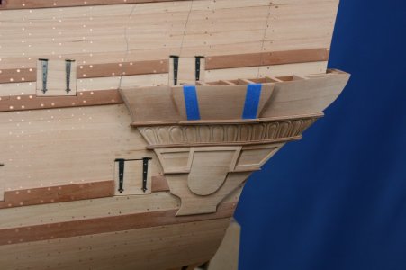

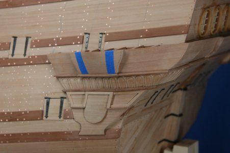

Hey Paul, I had to do some catching up. First of all it’s really taking shape! Good work.
On the issue of the lower section, in my eyes it is leaning to the bow too much and the angle should be more inline with the upper portion. Look for more symmetry about your vertical line, which is a slight angle towards the bow, but is constant through the upper and lower. Hope that makes sense.
Paul, this is what I am refering to...
As you can see the vertical center from top to bottom is at a constant angle, however symmetry is not perfectly established in some areas.
If it were me, I would print this and scale it to fit on your ship properly and use it as a template. Mark the angle on your ship and use the pic above as a template to align all features about the center line. And note the carvings you made are at angles too, not vertical. They fan out from the center in both directions.
Hope this helps.
