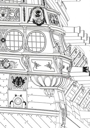

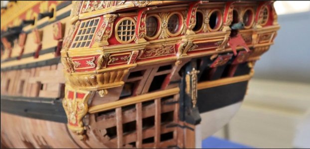

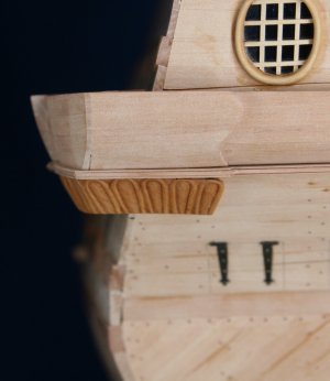

I hate to be the bearer of bad news, but the new structure isn't entirely correct. Please don't do anything stupid, I don't want you to have to reassemble this structure and waste another month of your life.. Just notice it and accept it you'll do it better next time. Each time I look at Saint Philippe QG, I discover new details that I hadn't noticed at first glance.
It's very important to look at every element from diffrent plans top, bottom, left, right, carved, uncarved. Even the sculpture drawings are helpful despite being only a vision. Do you want to play a little game, or should I get right to the point? I'll show you a couple of images—maybe you'll get it right away.
Tip: Look at shadow
Thanks, Wojtas. I do see the shadow and the step it reveals. The Villiers text seems to show this structure quite differently from Lemineur. I am at work so I don't have the plates in front of me - but I believe the drawing that shows the platforms from above (the one that shows the details of the quarter gallery framing) presents a smooth curve (similar to what Igor shows in his digital model) rather than an abrupt step.

I think marteen is right. It looks a lot like the middle part of this "bow-window" protrudes with sharp angles, as well the freeze beneath it. Most respect in any case... whatever decision you will be making, it's a talk on science-fiction skills...
Yes, and I agree. To me, the middle section looks a little too flat, if done correctly, the shadow in your photo should be much smaller, but maybe it's just a matter of the photo.
If you look at the plan I marked with red lines(in my previosus post), you'll see that the background belt almost touches the rail in the middle and tapers off on the left and right sides+ with the added carvings, the shadow should be minimal, like in Igor's design or the Rochefort model.
It's no big deal to me, but you've always been a perfectionist, so I thought I should mention it. If you're fine with it, so am I.:)
On plans the gap between carvings and rail is very very small

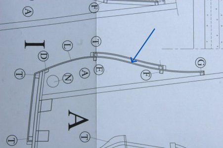

I'm not so sure, Maarten. At least Lemineur does not envision this section with a vertical jump/step as depicted in the Villiers drawing. Here is the platform just above the frieze:
The form is smooth not stepped (yes, there is a raised panel shown above (I have modeled that) but the platform itself is not stepped).

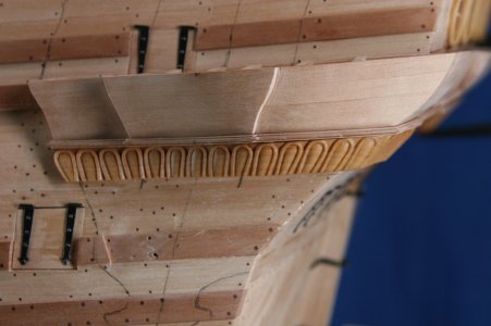

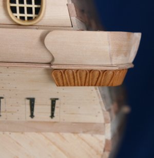

I cannot say you are wrong, Wojtas. But the difference between what you envision and what I have made is perhaps not as much as you think. Here is my frieze from above:
I would say I am quite close to what Igor modeled - though I am reluctant to appeal to his example - looking too much at his digital model is what got me in trouble in the first place Speechless.

Indeed, I'll be keeping what I have even if it is not quite perfect. As we discussed over lunch I struggled with the notion of a do-over in the first place. To keep going back to the same well seems unhealthy.
Still, I do very much appreciate that people have questioned my construction. It is only because they care and have my best outcome in mind that these challenges are raised. I am not diminished or hurt by sincere criticism - after all, this is just a hobby for me.

For what it is worth - the Tuset model agrees in full with what Maarten and you are suggesting.

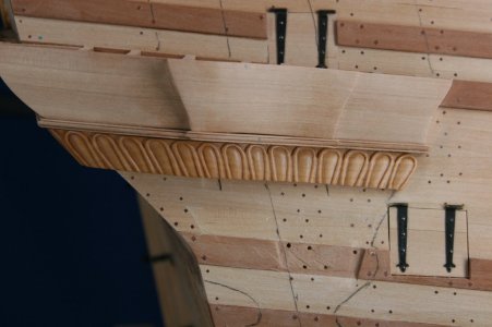

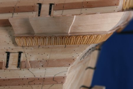

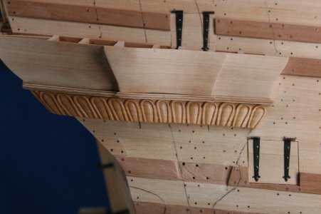

Work has continued on the (re)fabrication of the carved band of the quarter galleries.
I've decided that I'm just not that great at geometric/shape carving :rolleyes: - and since I previously demonstrated that I'm also not that great at figure/anthropomorphic carving while building the Kingfisher Redface - it would seem this current project faces some significant headwinds :).
Nevertheless, onward we go...
I did apply a finish to this carved section just to see how it would look.

Don't be hard on yourself. The carving looks great. It is uniformly consistent, which is most of the battle, IMO.
Thanks, Marc. As I wrote to Andreas my vision was not fully realized - and you know I can be quite self-critical. But of course you are right - the carving is not that bad. I did try to make things as uniform and flowing as I could.
