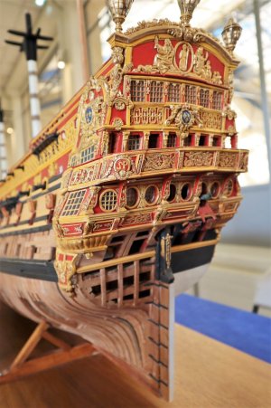

Hi Stephan,
These windows are a fake structure directly placed on the hull. The don't protrude from the ships hull and therefore are invisible from the stern.
In that case the ornament on top and bottom are flat too. And the difference between left and right from the centerline is correct. Too fake the look from a distance that it is shaped. No artistic look needed.
IceT would say: "Those fake ass French bitches" Alien

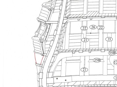

Now these dots you connect with ruler to the lowest point of the gallery as these lines should coverge to this point. Now draw the lines at these angles across the panel. This should result in a panel with lines giving you the orientation of your carvings. Now you can simply draw the carvings radii and start carving.
Brilliant for its simplicity.

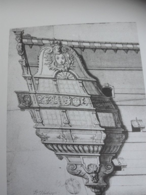

Yup, the same problem of a 2D drawing that's actually a 3D form. the way Maarten discribes is a good solution to solve the problem.
I think the part left of the red line and the part on the right are almost equal, the same . Only the right is draw under an angle. It's a difficult thing for a brain to see the 3D shape in a 2D drawing. You need to train that by drawing 3D shapes. For example, draw a circle in a sqare on paper, devide it vertical with a line. Then make a fold along that vertical line and fold that part back. Now look to the left part and see what the right part does when you fold that back. That part will get narrow like the drawing you use. Where the fold possible is between window 2 and 3. Hope that helps.
Good advice, Stephan!

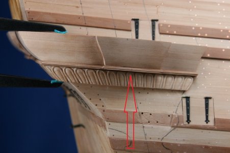

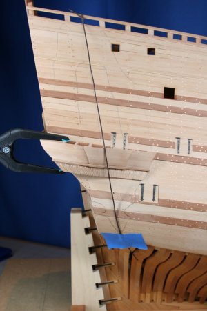

Hey Paul, I had to do some catching up. First of all it’s really taking shape! Good work.

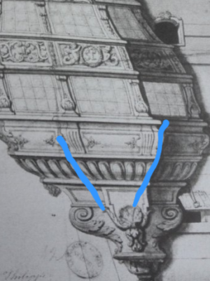

On the issue of the lower section, in my eyes it is leaning to the bow too much and the angle should be more inline with the upper portion. Look for more symmetry about your vertical line, which is a slight angle towards the bow, but is constant through the upper and lower. Hope that makes sense.
Paul, this is what I am refering to...
As you can see the vertical center from top to bottom is at a constant angle, however symmetry is not perfectly established in some areas.
If it were me, I would print this and scale it to fit on your ship properly and use it as a template. Mark the angle on your ship and use the pic above as a template to align all features about the center line. And note the carvings you made are at angles too, not vertical. They fan out from the center in both directions.
Hope this helps.
And it seems that angle is the same as the stern angle on both ships. So that’s a good guide IMO. Just figure out the offset distance. ;)
Thanks for sharing your thoughts and suggestions, Dean! Much appreciated and all very helpful!

But the balcony sections are not a facade so we end up with a single drawing that represents two things.
It isn't quite that the upper and lower finishings are flat. They're not painted on. Rather, they are low-relief, superficial structures that give the impression of a rounded form. I don't know this for certain, but I strongly suspect that trompe l'oeil painting techniques were also incorporated into these superficial structures to further lend a sense of depth.
For the French ships, in particular, the stern and quarter galleries take their cues from land-based palace architecture. They were quite literally designed to be palaces on the sea.

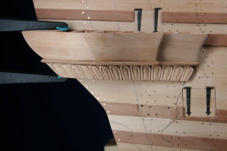

Hello Friends,
My thanks to all the people who shared their observations about the alignment of the lower portion of my Saint Philippe quarter galleries.
What seemed so obvious in the 'thinking about it' stage tragically unraveled during the 'building it' stage. In one sense I'm sort of embarrassed by my work. But this structure is more complicated than it appears in a line drawing, and I take a bit of consolation in the simple truth that I have been out of my depth for about a year now building this model - and I shouldn't be all that surprised that some hard learning would be part of the process. In this case, a bit of denial in the early stage of questioning led to the loss of one full month of construction progress. Lesson learned.
Again, my thanks to those who offered suggestions and corrections - this forum has the ability to be very kind and helpful when it's not being a total jerk (yes, one of my haters also got involved :) though he lacked the courage to mock me (is that what you did???) on the public facing side of the forum).
This is not a very extensive update (stbd side only) because the deconstruction process created some collateral damage which needed to be addressed. And then there was the necessary progression through the stages of loss: denial, anger, depression, acceptance. How silly - it's a ship model...
Here is the before and after (before on top):
Can you believe I tossed out a month's worth of work for that small difference? What an odd group we are...
Yes, I can believe it. The difference is not all that small.
It is the carving that makes the waste so painful. The more that you do the carving, the faster and more proficient you will become with it.

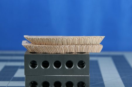

One question: you mentioned the difficulty in carving the end grain. It is something to be avoided if at all possible. Did you end up making it two pieces with a cove joint at the corner? It is just a form of crown moulding after all. It is at the outlet of an outhouse.

Hi Pual
I hate to be the bearer of bad news, but the new structure isn't entirely correct. Please don't do anything stupid, I don't want you to have to reassemble this structure and waste another month of your life.. Just notice it and accept it you'll do it better next time. Each time I look at Saint Philippe QG, I discover new details that I hadn't noticed at first glance.
It's very important to look at every element from diffrent plans top, bottom, left, right, carved, uncarved. Even the sculpture drawings are helpful despite being only a vision. Do you want to play a little game, or should I get right to the point? I'll show you a couple of images—maybe you'll get it right away.

Looks much better Paul - in my mind well worth the effort - this is a good proving ground for all that will demanded later with more complicated shapes and carvings.
Good morning Paul. To my untrained eye I can see a marked difference and improvement in the carving and shape. Whether it is correct or not I have no idea however it came out really well. Cheers Grant
Hi Paul,
Certainly a huge improvement and worth all the efforts.

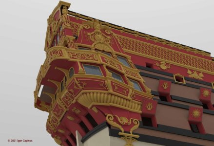

Indeed @WojtasS is correct.
Even the model shown by him is not representing the drawing completely, as also the jump in the freeze is present in the carving below it.
I can imagine in your line of work protruding parts is a frame are not wanted and a straight line is aimed for. :-)
But your current works fits the other shown model so it will give a good appearence on the final gallery.
