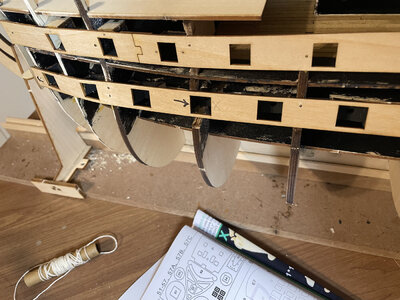

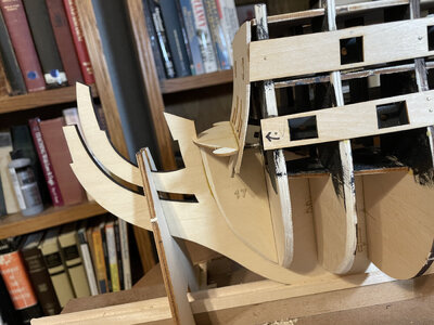

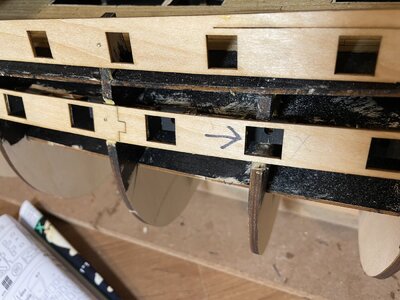

Now I’m wondering if I should have cut into the bulkheads to inset the plywood gunport strips. Will they leave a ridge when I cover them with planks?
I don't think it would be necessary. Ask yourself, what do I trying to archive by doing this? However, if you will cut into the bulkheads, you will change geometry of the bulkhead. when you lay down the first layer of planks, there will be a gap in height between the gunport ply and the planking material, IMHO
Won't that cause a ridge or bump in the planking?
Are you saying, that the gunport board is thicker than the first layer plank? I am a bit confused.

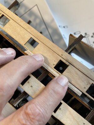

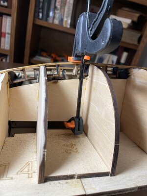

The strip broke partially through when I was fitting it, so I added some pva/water solution to the crack and put a clamp on it. I had to take off the head of the clamp and put it back on upside down to get it to fit under the false deck. I hope this works!image.jpg

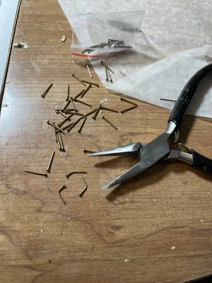

So, I was bending a lot of these little nails when attaching the plywood gun port strips to the bulkheads. It finally dawned on me to drill through the strips and place the nails in the holes with a needle nose pliers and hammer them into just the bulkheads. Never bent another nail. image.jpg
