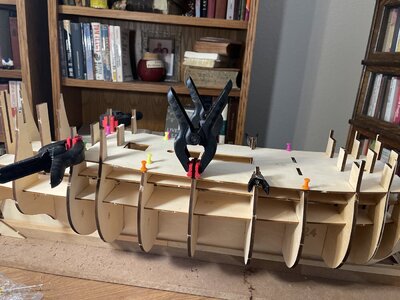

When I attached the deck, it seems the decks are a little (2-3 mm) high where the aft bulkheads begin. I thought I had pushed the bulkhead down sufficiently. But it's just enough that it looks a tad high at that point--not perfectly straight. I suppose a little sanding will work. Also, the instructions note I will have to add some scrap wood in the aft portion. Do you know what that's about?
Hello Vic
THe reason why I added a 5mm filler under the front of the poop deck was that it looked too much leaning forward.
Looking at the instructions, it appears the main deck slopes upward aft. Also, the deck slopes toward the hull from the center, providing a slight arch in the deck. I had to use clamps and pins to hold the deck down on the sides. Did the actual ships have a crown like that so the water would drain to the sides?image.jpg
The slight arch to the sides is normal. That is why there are scuppers in the waterways to keep the deck clear from standing water. The longitudinal curve aft seems quite pronounced, but only the experienced SR builders will tell be able to tell you if that is normal.
No Vic. Don't sand that down now. Wait until you fair the whole hull. That way you make sure that everything is in line. That curvature of the deck actually helps during the fairing process.
I suppose that makes sense. Only the main deck seems to stick out to the bulkheads, though.

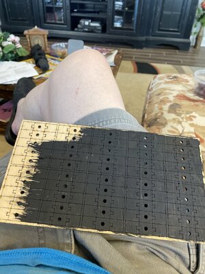

Lots of progress for your first week looks magnificent. That's a lot of little boxes, l was happy when they were all installed on the Pearl and there where olny 20 to do. Did the parts for the work stand come with the kit?
