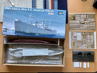

Yesss, started!

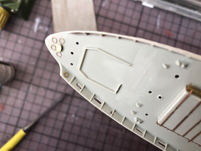

The box arrived with two frames of PE from Eduard and a folding thing. New stuff for me, I am exited to see how I am going to manage all this.IMG_8017.jpeg

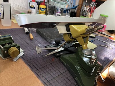

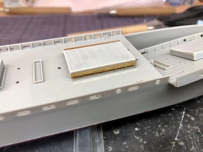

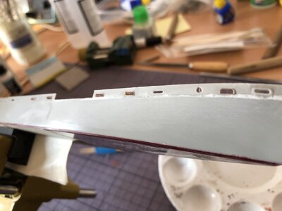

The first thing I did was to glue the waterline bottom in place and I made something with two pieces of masking tape to hold the ship in my vice and orientate it in every direction to help me to put the PE parts on vertical walls.

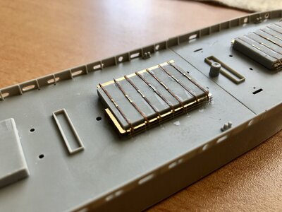

Then the PE adventure really started. Bending and gluing and in the meantime try to be as creative as possible to figure out how everything could be done easily and effectively.

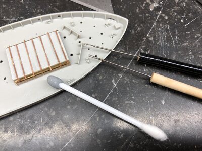

So far it went quite nice. I learned very quickly that picking up a small piece with tweezers on the sides is a guaranteed loss of the part, so I used a bit of sticky gum on a stick to manipulate the parts. Also a cut-open embroidery needle was very helpful to apply a very small amount of CA glue on the desired place, without glueing fingers to the ship.
In the end I managed to fix already quite some minuscule parts in different positions.

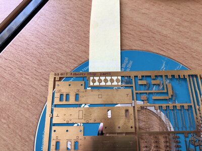

I learned that while cutting the parts free form the frame, it was an ideal moment to have things disappear in plain sight, so I used the glue strip of a yellow note sheet to fix the parts while cutting and transporting them.
Finally I was helped by someone from a Dutch forum to find a solution for fixating these little things by applying some small drops of PVA glue to stick the parts in place and after drying I added a bit of CA glue with the needle-fork. It worked quite nice!
Pfff... this is really challenging and very rewarding to discover so much new tricks!

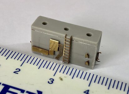

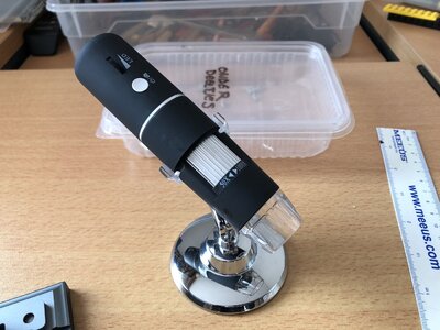

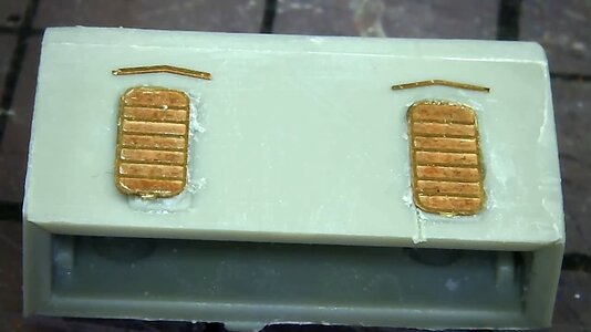

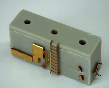

This Photo Etch stuff is really something... I happen to have a little WiFi microscope and that really helps me in judging my work. It is not so easy to use with the construction, because it is 2D and it is very hard to judge how far you are from the surface, but nice to look at the results. And you really see where you have to improve!!!
The thing I am building now is a chamber that supports the loading installation and it contains the steam lines from the engine room.
On the stern side there are two doors with a rain protection and on the other side the connection of the steampipes with the winches. Also some of the hose reels and a ladder and on the sides two holders with lifebuoys, sorry for my poor English :-( .
With the microscope it is really visible that:
. the ladder is not bent symmetrical left and right
. the ladder is too high (which explained why it did not glue on the side above)
. the connection boxes are not bent in the same direction
Okay, I don't mind so very much, it is really so very small and I don't think that you will ever notice it in the end, but it teaches me where to improve and where to hone my skills. I keep being amazed how small everything is!!!
I still need to put more PE-parts to this little assembly of not even 2 cm long!
