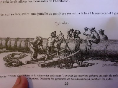

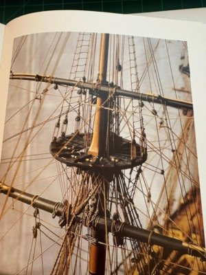

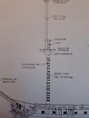

first question , while on the subject of reinforcements, will you be fitting Jumelles? mast hounds ?(wooden battens that support the mast at the point of movement of the yard )These are fitted after the mastbands (which i now have info at width, 1/7 thickness of the mast at a distance of "3 pieds à 3 pieds et demi" so you are about right at 1metre) but then attached with rustures (wooldings) , their height should be equal to between 3/7 and 1/2 the open mast height.? i'll find some photo's
Martin! This is great stuff my friend! Thank you! Short answer is maybe not.
Blessings. Peace. Gratitude.
Chuck

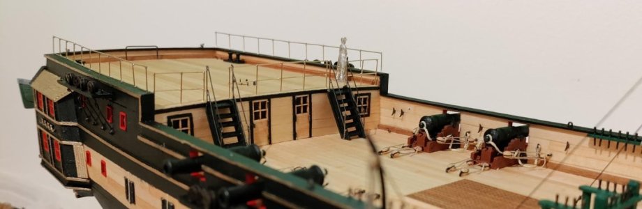

sorry ,i responded when half awake at 5 in the morning Sleep, not really with it ! here's a bunch of busy frenchmen attaching a Jumelle to the mast, it is really to protect it when raisng and lowering the yards and is disposable. the second photo shows a shorter version from 1740 but they gradually got longer until almost reaching the deck, not fitted to the mizzen mast

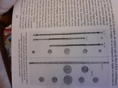

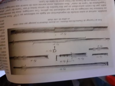

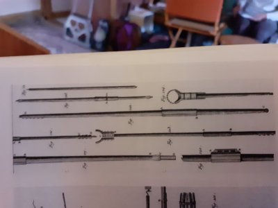

on to yards, everything i have points to them normally being reinforced by the octagonal centre section up until the introduction of steel yards but that would be later than L'Orenoque; dimensions are given as length = 5 times width of the yard, the diameter being 1 inch larger than that of the yard (from "L'art de la Voilure" by Charles Nicolas Romme 1781) i have included some illustrations from his tomes which will give you some clues as to the "taquets" the cleats and jams typically used, and also the iron reinforcing circlets.(1st pic) bit difficult to see but the intricate internal dovetails used to hold the two halves of the yard together are quite something, (2nd pic)
That should be enough to give you some headaches for now, ROTFif you have any other queries i will see what i can find.

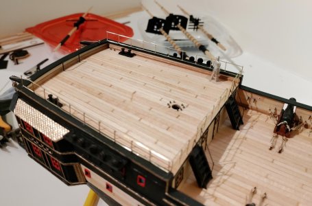

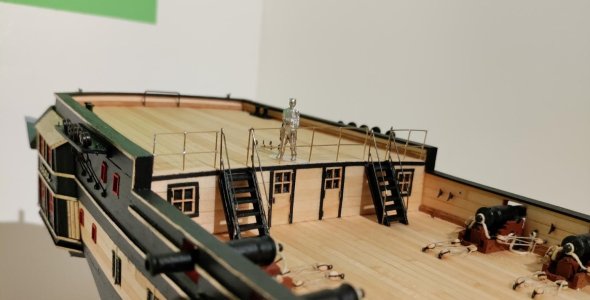

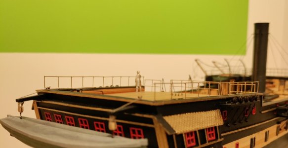

Perfection! Nice job on the rails!
Paul! Thank you for the compliment! Somehow you always make it weird - "perfection" ReallyROTFROTFROTF Coming from Mr. Perfectionist himself.ROTFROTFROTF
Here's what you would do (and I am NOT going to do - at least I don't think I am) you would tear out and replace the railing at the head and the railing on the sponsons. Tell me I'm wrong - dare you!ROTF
