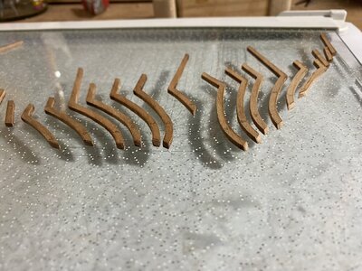

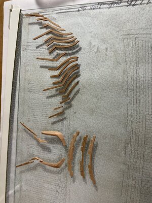

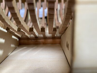

Hi Don, I file them after assembly. It gives me a better “stemless” joint where the futtock joints the floor and top timbers and it is also better to leave the parts untreated as this will give you a more accurate fit when you assemble the individual ribs using the drawing as the drawings are based on the parts before fairing. I initially did remove some of the char prior to assembling the ribs but I have now decided it is to treat the ribs after assembly all together. I will attach a pic that hopefully shows the continuing lines after filing the complete ribs on the subsequent ribs.

It is also my experience, that you should assemble a complete frame and fair afterwards - I tried it different on one frame and the result wasn´t so good !
@Chello : your three frames are looking very good - especially on midship frames you acn immediately see how good theses teeth of three frames are fitting one another - Very good work !!!
And I am happy, that your files are also working very well - they produce also a very good surface
and something else: good, that you started midship frames - more fore and aft will take more time, but with more experience it is getting much faster - I am very happy, that I finished the main works on the frames during the weekend

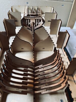

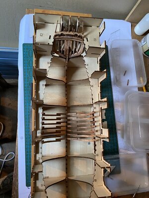

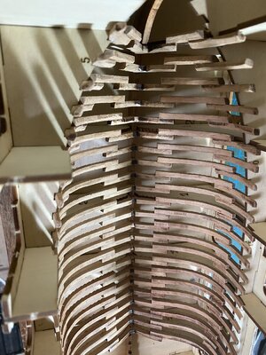

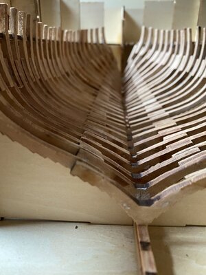

After days of endless filing it finally feels I’m getting somewhere. I have dry fitted the frames I faired on the keel in the jig (good place to keep then and a good motivator as you see something taking shape). Very happy with the fit so far, considering I will give all the frames a final work over before the stage where they get glued to the keel. Particularly the top timbers will need accurate fairing before assembly as I have done them roughly now. I have decided to sand and fair the inside of the frames after assembly to get an even smooth overall finish. Hope to get all the frames done this weekend and then it’s the aftcastle next. Had a look at the parts and this step looks tricky. Hoping some of the group builds will overtake me so I can learn from others.

very nice clean work Chello
Cheers kiddo. To be honest I have al aya been very intimidated by the cleanliness and crispy finishing of others. I now know that besides experience, and types of wood, tools, skills , the amount of alcohol consumed the day before, the light and camera angle, it mostly depends on patience and looking 3 steps ahead. With My first frames I wanted them to look perfect, now I realise they need to go through many processes first before they have to look “perfect”.

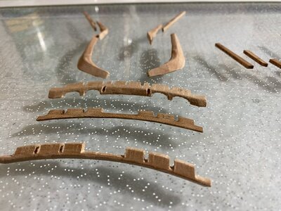

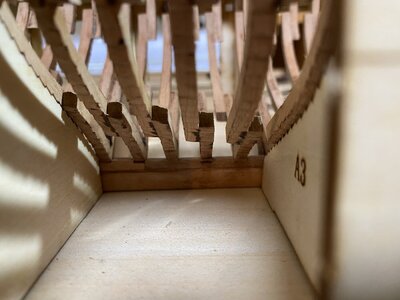

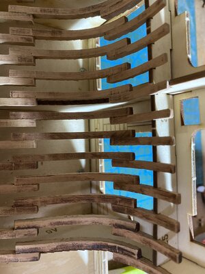

So, I wanted to post a comprehensive log of building the stern section of Le Coureur. Looking at the drawings, the parts .pictures of other builds including CAF’s Tom I knew it was going to be tricky. Well, in short it was! I’ll spare you a build log as it was going from plan A to plan Z with tweaks in between. The only thing I can say is, take your time, think 5 steps ahead and don’t be afraid to start again. I kinda ended up building it half inside the jig and half outside. Nevertheless it’s done and next weekend I’ll be able to glue the frames in after a final work over.
In conclusion a very challenging part of the build but so much fun!!
