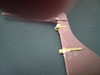

This is how my new hinges will be. I found a pram in the harbor and this what the hinges were like, not the short ones the kit provided.
I have to remove the upper hinge. Hopefully these new hinges will work. I had broken the tiller three times in three different places too, might redo that too.

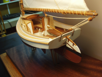

As for the "hinges." They are called "gudgeons" and "pintles." The gudgeon is the half that's attached to the boat and the pintle is the part attached to the rudder. The pintle has a "pin" on it that fits into the gudgeon, so that's an easy way to remember the difference. In my experience, the easiest way to make a credible representation of a gudgeon and pintle at the scale you're working with is as follows:
Perform the following steps for each pintle and gudgeon set you require. Some larger rudders will require more than two sets.
1. Cut two strips of brass or copper sheet stock of suitable widths and lengths to serve as the straps for the gudgeons and pintles.
2. Take a length of brass (or copper) tubing stock with a diameter as thick as the leading edge of the rudder is wide and cut two lengths, each as long as the width of the straps in 1. above. (Most hobby shops will carry such tubing.)
3. Take a length of wire of the same diameter as the inside of your tubing and cut a length as long as the lengths of the two lengths of the two sections of brass tubing in 2. above combined.
4. Insert the wire into one of the sections of brass tube for the full length of the tubing. Solder the wire and the tube together. (Or use thin cyanoacrylate adhesive to glue them together.) File the edge of the tubing that the wire doesn't protrude from flat so that the wire and tubing appear at that end to be one.
5. Obtain suitably sized (small) brass "lill" or "sequin" pins (e.g., https://micromark.com/products/mini-nails-3-8-inch-long-x-020-inch-dia-pkg-of-100?keyword=pins) length unimportant.
5. Drill holes the same diameter as the in the ends of the brass or copper straps where fastenings should be placed. Take care to drill holes exactly in the center of the strap and exactly the same distance from each end of each strap. (The gudgeon strap will be shorter than the pintle strap, of course.)
6. Fold the brass straps exactly in half, bending them 90 degrees around each length of tubing. Place the long strap for the pintle around the section of tubing with the wire in it. Place the short strap around the hollow length of tubing and bend the ends of the straps outward 90 degrees again to form the base for the gudgeon. Solder the straps and the lengths of tubing together. (Or glue with thin cyanoacrylate adhesive.) Clean excess solder (or glue) from the parts created using a fine file or wire brush. Thoroughly clean the parts by washing them in vinegar. "Blacken" or paint the pintle and gudgeon or leave bare to allow it to develop a natural patina over time.
7. To mount the gudgeon to the sternpost or transom, determine its placement on the centerline of the model and drill the mounting holes in the transom or sternpost where required to line up with the holes drilled in the mounting strap. Don't drill all the way through the transom unless the transom is only a board thick, as in a dinghy, in which case drill all the way through and make a matching inboard backing plate of brass or copper sheet to match the gudgeon base on the outboard side. Cut brass pins to suitable length and insert them though the holes in the strap and mount the gudgeon by inserting the pins into the drilled mounting holes. If the gudgeon is mounted on a thin transom, only cut the pins to a length of half the thickness of the transom and, after mounting the gudgeon outboard, mount the backing plate and its mounting pins in the inboard ends of the holes drilled for the gudgeon. This will create the appearance of a drift bolt peened at either end. In a similar fashion, drill through the rudder and mount the pintle with a pin through each hole from either side to simulate a bolt peened at either side of the rudder, securing the straps with thin cyanoacrylate adhesive. Note that adhesive should be applied to the pins themselves, as well as the straps, and the pins should preferably be a tight fit in order to provide some measure of mechanical holding power in addition to the adhesive. Metal to painted, or even bare wooden, surfaces, provides a compromised bond that is no stronger than the paint film. Tightly driven pins will also probably provide enough holding power to avoid the need to clamp the straps to the surface when gluing.
8. Mount the rudder on the hull by inserting the pintles on the rudder into the gudgeons on the transom. The rudder will turn in the same manner as on the real boat.

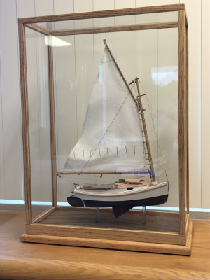

Below is a photo of my model of a 17' hard chined centerboard catboat I designed which I had handy in a pdf file. The photo isn't the best, but you can see the transom fittings modeled as described above if you look closely. The model is to the scale of 3/4ths of an inch to the foot.

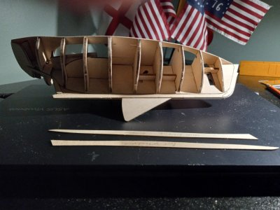

Ready to plank the Muscongus Bay Lobster Smack. Tricky clamping of the Garboard planks. Would CA do any good to clamp while drying on the frames? Opps, see a low spot on the deck, got to fix that

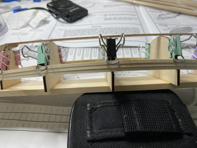

Fairing finished, trying to figure out how to clamp the Garboard planks, at the angls and curves, my clothespins and harbor freight clamps aren't working. Not sure about trying CA glues.
You can use rubber bands in a lot of areas to secure things. I also used modified binder clamps to help clamp things into position and hold them until they dried. you sake the "handles" off a binder clamp and carefully wedge it into the bottom of two other binder clamps. This works well.
