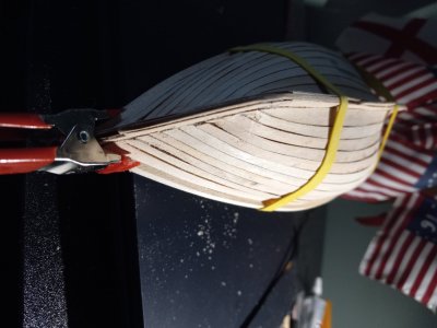

Thank you for the tips Rob444. Successfully bent the 3 3/4 railings, using Windex and hot water' and had it done before the "Boss" returned! Waiting for it to dry.
first two pictures shoe railing bent to shape but not glued yet.

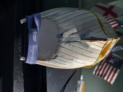

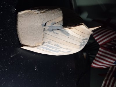

Last pic shows the messed up stern. I sawed the planks at the stern fron the deck to the keels, messing them up. I think some filler will correct this error.

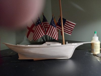

Deck shot with rails bent and glued on

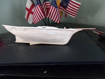

Super structure done, needs sanding, using Model Light white filler on deck cabin and hull planking. Questions, when using the filler do you put it on dry from the container or put it on wet? I put it on dry, and it will need a second coat of filler, do you just sand and recover? Once done and sanded, do you seal it prior to painting?

I fooled around with the wood filler and found it too dry, adding water and stirring was much better and a lot easier to work. Have to get some fine sandpaper for final prep prior to painting. What grade sand paper for final sanding prior to painting?

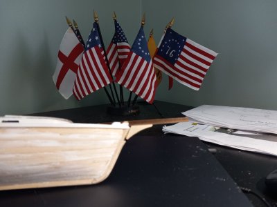

I messed up the beak. I had some rubber contCt cement spilled on it ans tried scraping it off with my Exacto. I took too much off so the beak didn,t align properly. Glued some scrap balsa on it to build the stem back up, we'll see if that works. I added filler at first with my fingers, need to put it on with a spatula, will have to add more filler , I also failed to mix enough water. After the beak repair is finished, I willredo the filler. Two more newbie mistakes!

With the filler, I find using several light "coats" letting the previous coat dry seems to work better than just putting on a single thick layer.

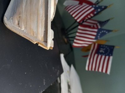

I think the beak will be presentable after painting. I have tried differing glues, and have come to the conclusion that yellow PVA is best for these20251102_082439.jpg models. Most of the problems started when I broke the stern frame work, that repair was a royal pain and I am not sure everything lined up
properly afterwards. I also think that the planking was not allowed enough time to become flexible enough in hot water, and I used the hottest water I could get from the tap, but now wish I had used boiling water instead. I used glues I had on hand instead of purchasing PVA, that resulted in set up times, clampimg issues and holding issues. I went to my local hoppy shop and purchased a bottle Evergreen yellow wood glue, enough for several more kits! and it works great!
