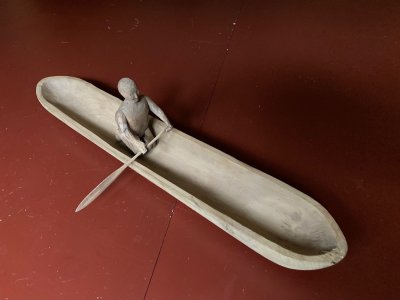

I live in northeastern New Jersey, which was earlier the home of the Lenape. While native Americans who lived further north are famous for their birchbark canoes, appropriate birch trees did not grow in this area. Therefore, the Lenape, like the Wampanoag, built dugouts, usually of large tulipifera trees. The Lenape word for boat is mùxul. The pic is my crude model of a Lenape mùxul. Fair winds!
