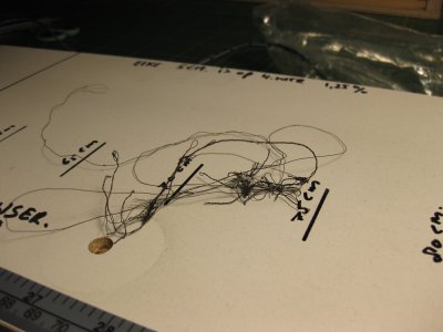

I discovered that when you make a 3x1 (or 2x1 / 4x1) thread from Skala, the same problem occurs as when using Amann’s Serafil 120/2. When you use a single thread in a strand, you can only make left-twisted rope. This is because you twist the rope against its natural twist when making right-twisted rope. There is a higher risk of breakage during twisting or irregularities. Like this:

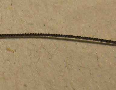

But if you turn it in LH the result is a perfect 0,2 mm rope.
Close-up photo; note the wood fibers in the paper below for a comparison of scale.
I used 40 grams of weight, 8% and not 10% before I started the turning of the rope. Both machines in same speed.
