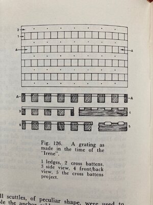

Figure below shows "A grating as made in the time of the 'Irene.'" This is from the book by E.W. Petrejus "Modelling the Brig-of-War Irene. She was a Dutch 10-gun brig built in 1806 in England as HMS Grasshopper. Petrejus says that gratings were made of heavy fir ledges laid athwartship crossed by oak battens of the same breadth but much thinner. He also says that properly made gratings look extremely well on a model but it is a "careful, tedious job." Fair winds!
This sketch is showing how the modeler Petrejus made the gratings of his model - very good hint
