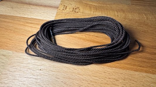

I needed larger ropes first because I’m building large scale ship models. My current build has been on hold for 2 months because I needed good quality rope suitable.
I could have purchased from Rope of Scale. As I had been. Buts it’s costing $200 per model by the time I buy the ropes and pay freight.
I can’t afford to keep paying that per model build.
So I looked into options and have to be honest that first option you mentioned did not work for me. I can give many reasons why. I will not get into them here. Probably never will, because the PL4-4 does have a place if you want to only make smaller ropes and use the appropriate threads.
This rope walk is awesome. Does everything I need and with some practice is very easy to make great looking rope.
It’s a huge learning curve. Making rope. And I’m finally there. With the help of this awesome rope walk.

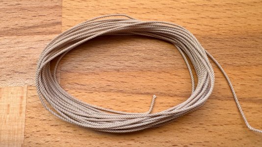

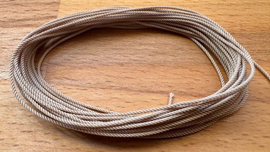

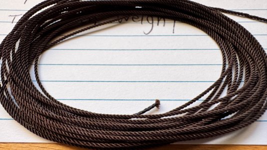

First rope made with a distance of 6.2 meters between Bok and Wein.
Weight 750 grams at 10% in first wind.
Gutermann E151 3x15 1.3mm rope
Finished rope measured at 4.83 meters. Which has surprised me. I thought I would have gotten at least 5 meters.
Maybe too much weight. I will try a bit less weight tomorrow.
The rope looks great. Just need an additional 20cm

This rope is 1.3mm, which is less than most 1/48 scale models use for basic rigging.
