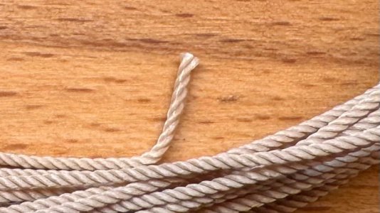

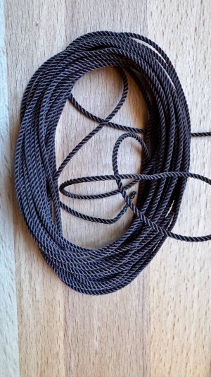

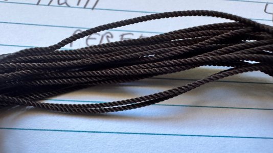

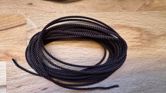

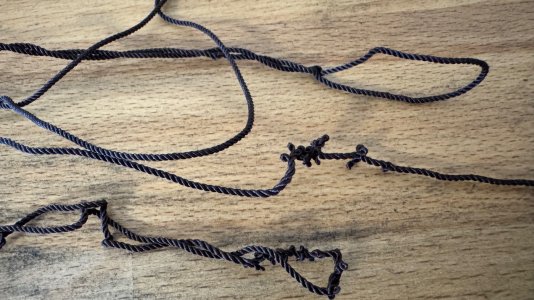

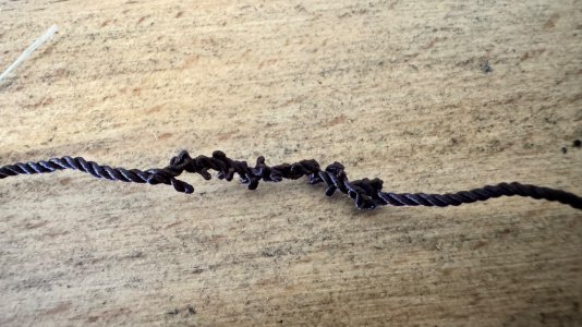

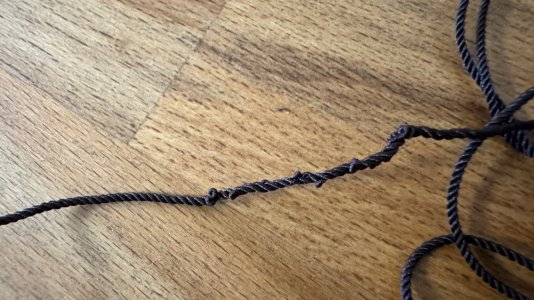

I’m new to this forum and this is my first post. I’ve been trying to make ropes for the past two weeks, but it’s been a complete disaster. So far, I’ve only managed to waste thread and time with the PL4-3 machine from Mr. Aleksei Domanov.
As you can see in the photos, the ropes come out badly twisted and lose almost all their tension. When I tried twisting them in the opposite direction, they turned into a massive tangle, forcing me to stop the machine.
Honestly, for the price I paid, I expected something much better. At this point, I don’t think it’s good for anything at all. Now the main issue will be the return process, since I live in the USA and Mr. Domanov is in Poland.
I’m writing in English in case someone else here owns the same machine and might be able to help. I’d really appreciate the chance to connect with you and hear about your experience using it. I bought a PL4-3, and so far, all I’ve accomplished is wasting thread.
To be honest, I’ve felt like throwing it in the trash—but after reading your posts, I see you speak very highly of it. If you don’t mind, I would greatly appreciate any advice you can share. You can even reply in Polish, or send a private message if you prefer.
I’ve attached some photos so you can see the kind of "ropes" the machine is producing for me. Any help would be greatly appreciated.

As a general contractor, architect, and engineer, I’m fairly comfortable with the technical side of machinery, and I’m always learning something new each day to have the opportunity to expand my knowledge. As I explained in another post, I have encountered several setbacks during the attempt, and I have run into a few challenges that I’m still trying to work through. For instance, I had a bobbin come loose while the machine was running, and I’ve also noticed that the wheel holding the three bobbins seems to wobble from side to side rather than rotating smoothly on its axis. This appears to affect how the gears engage, as they sometimes feel like they are slipping and the noise becomes unbearable.

Bob don't worry, my friend—it's absolutely no problem at all. I know that on these forums we can find a lot of interesting things, as well as plenty of experts. Even if some people are just here to learn without sharing their own ideas and experiences—well, there's a place for everyone!Sorry about incorrectly underestimating your mechanical experience with tools! It's one of the hazards of these forums. You never know, so you tend to presume the person asking a question doesn't know as much they do unless they tell you!
Bobbins should not come loose when the machine is operating. Perhaps one wasn't tightened enough. The felt washers on either side of the bobbins are important. The pressure from the wing nuts against the felt washers creates the friction that regulates the tension on the strand as it comes off the bobbin.
The planetary wheel (the big one that rotates the bobbins) should not wobble. Everything on the machine should rotate smoothly and not wobble or create a lot of noise from grinding gears. It sounds like there may be a problem with the assembly of your machine. Mine came partially disassembled. As I recall, it was important that some of the parts were installed in the correct orientation. Perhaps a wheel is on backwards or something. I can't diagnose it from here, but it from your description you have a mechanical problem that should be easy enough to figure out by watching the thing run. (Slowly... you don't want to break something!)
Phillipsart is correct that the PL4's capacity is limited by the amount of thread that can be wound on the bobbin and thus also by the thickness of the thread. If one is going to make large diameter scale line, the PL4 probably isn't the best machine to select.
There isn't any way I know of to really wind thread on a sewing machine bobbin evenly without a bobbin winder. Every sewing machine has one built in these days, but for our purposes, if a sewing machine isn't handy, a stand alone bobbin winder is the tool for the job. They are not at all expensive and make quick work of loading a standard bobbin evenly and under the tension you set. Mine runs on AA batteries.
