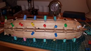

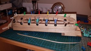

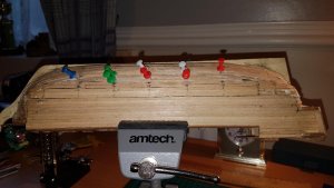

Very nice progress, Bazzg! If you don't mind, as a suggestion so that the planks fit well to the frames 'fair' the bulkheads first, Use wood fillers in the bow and stern sections. Also, you can soak planks in the hot water and slightly bent. This is double-planking kit so you will have a chance to correct once it is completely dried.

Very nice progress, Bazzg! If you don't mind, as a suggestion so that the planks fit well to the frames 'fair' the bulkheads first, Use wood fillers in the bow and stern sections. Also, you can soak planks in the hot water and slightly bent. This is double-planking kit so you will have a to correct curves at a later time (once all dried)
Waiting for Wood Filler, i soaked planks in boiling water and used Iron to Help Bend them, did not realise it was double planked until told as the Templates act as the second planking.

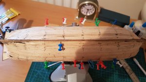

I think this is how i add to my Build anyway i have finished the first planking,i think it's not bad for first attempt, now to sand but first it say's after sanding i need to coat with Allphatic Glue then sand again what is Allphatic Glue i have bought some Sand and Seal is this the same.

Hey Brother,
This is the information I got from the web.
Aliphatic resin glue is what we commonly know as “yellow glue” or “carpenter's glue”. It is similar to PVA (white glue), but has been modified to make it stronger and more moisture resistant. Titebond Original is one of the most common aliphatic glues sold in the US.
It is different from sanding sealer which is used to seal the wood and once sanded will leave a smooth finish. If I had to guess, aliphatic resin glue is to be used as a bonding agent for the next layer of planks you will add.
Ray

Aliphatic glue is not used as sanding sealer. It is used to cement things, not coat them.
As Ray said, use a good sanding sealer for that effect.
Never heard of using aliphatic (or PVA) to coat. Who told you to do so?
