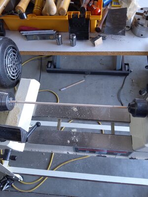

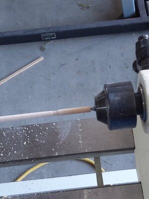

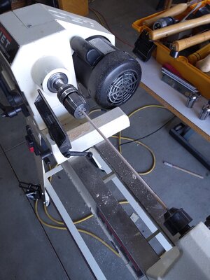

I used a lathe with a collet system. With calipers to measre the diameters, I turn reference lands the taper with micro (EZ Tools) gouges to taper. Follow with careful sanding while still on the lathe.
