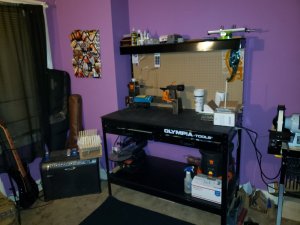

My new room is nearing completion I still need to pain it in the spring remove the carpet and put down a hardwood floor. but for now it will suffice with carpet and purple walls.
waiting on another bench to build my ships on and that should be it for awhile and will allow me to get back to building
