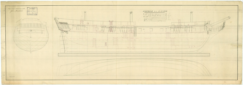

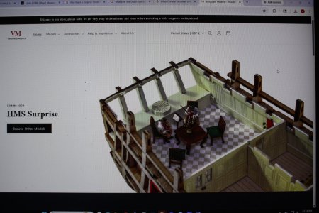

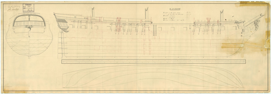

have you looked at the New Model due any time from Vangaurd Models Not Rigged but fully enclosed
Is this the HMS Surprise/Unité kit they show coming out soon? I hope the photo on their website is not supposed to be the Surprise.
