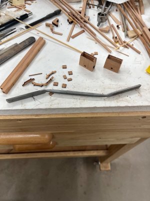

@TRS7139, so sorry for the beginner question: what is an "angled rifler"? would you have a picture to illustrate? thank you so much.
No problem, here it is.Alas , forgotten where I sourced it but should be an easy find.
The side cut is almost exactly proper thickness for carlings and it cuts well.
Tim

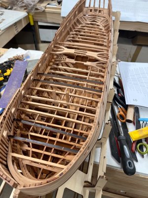

Lastly,
Taking a little break from beams/knees. A little work on gun deck, pumps, and upper well. Think I worked out process to mill slots for upper posts to fit angled slats. Probably make thinner slats as well. We'll see
Tim
