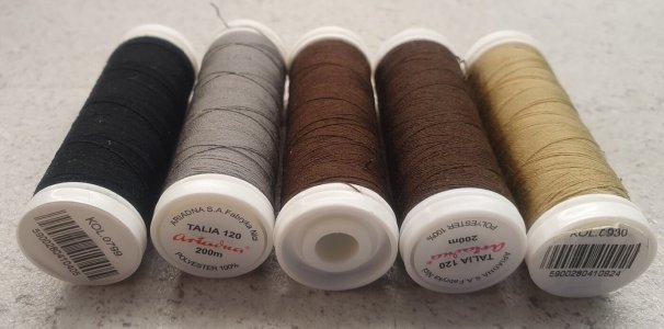

Nothing new. I have these threads in size 120tex, 70tex, 30tex, others are also not available to me. First i make 3x120tec from which I have a line of about 0.10 mm, then i take 3x0.10 mm and i have about 0.4 mm and so on. Or i simply mix them by size one more inside core. Sometimes i use other threads, e.g. Polish Ariadna talia numbering ash 0916, beige 0930, black 0799, brown 0772. These are similar colors. First, try spinning any waste thread with a TEX mix of whatever thickness you want.
For Mara 120 the tex is 25 is about the threads that i'm using now, so I'm more limited with sizes i will check out the polish company that you offerd

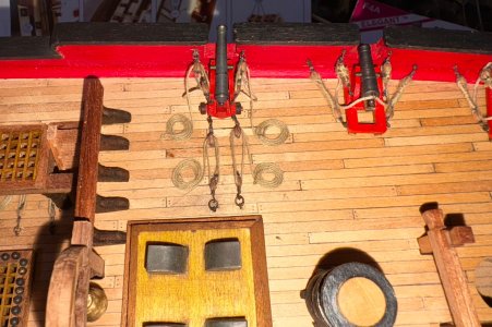

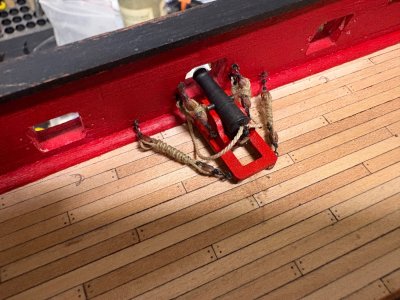

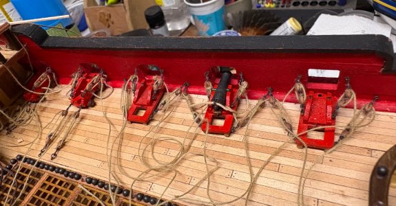

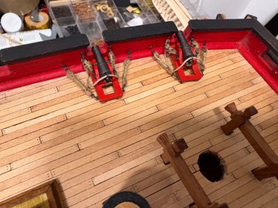

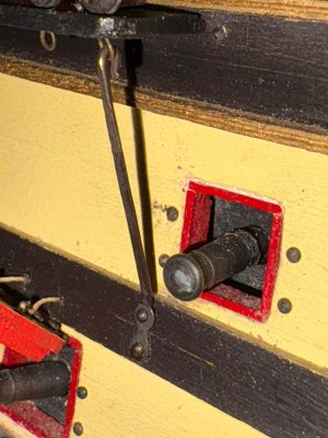

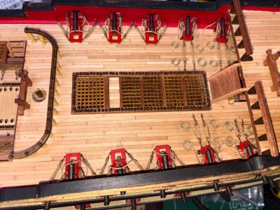

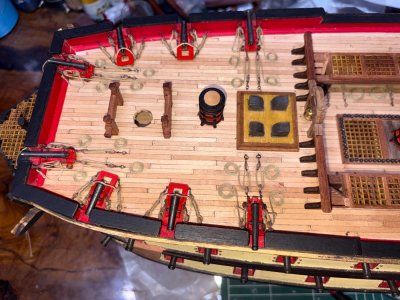

I like the different gun rigging for different style of guns.
Thanks, i'm not really sure if it's the correct way of rigging the corrandes, I had some great reference form some scematics, but it's on my old phone (very hope so ROTF), but also the rigging from the Uss Constitution was pretty resembles to the schematics so I used this rigging as reference.

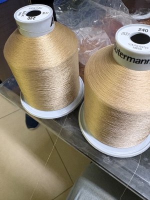

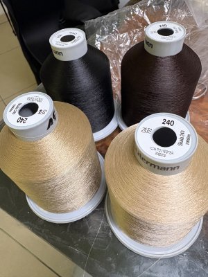

I Got the Gutermann Skala 240 yesterday.
The quality of the threads are excellent.
Colors 722,464,696 and 000

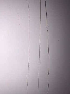

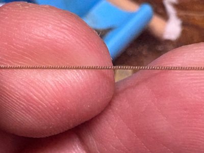

Three tests , 1 thread on each hook 2,and 3 threads on each hook results ≈0.2, 0.3, 0.4

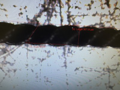

And the 0.4 under the microscope .

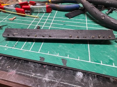

It's the channels time.

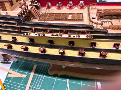

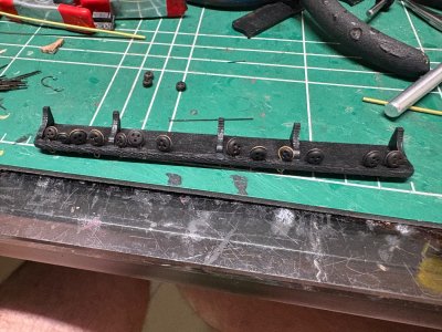

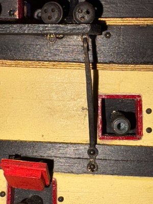

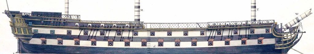

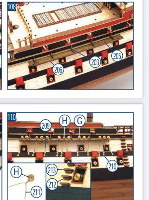

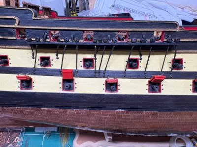

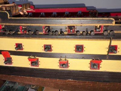

To be little more authentic i placed the channels as in the illustration of the ship starboard side and not as OcCre suggested in their instructions.
and i had to reconfigure accordingly to the gunports the deadeyes locations,but i still went with OcCre's amount and sizes of the deadeyes in each channel.

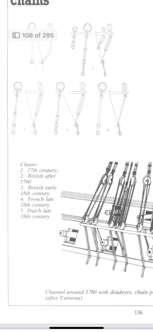

For the chain plates: for the deadeyes links i only formed the 0.5mm wire as shown in the book HSM and for the middle link i used the the dutch way for the late 18th century way of seizing the deadeyes .
So with A small mishmash with OcCre's preventer links that they provided I hammered down the 1mm brass wire to a small strap and attached all together.
Only 5 channels to go.
