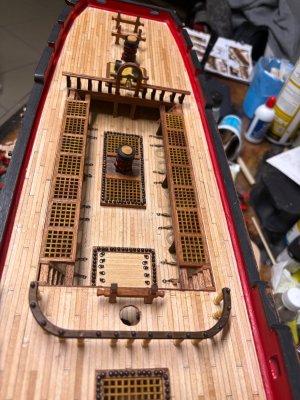

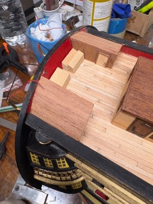

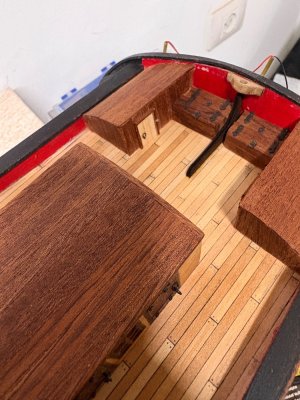

so we had passover holiday and we ate matzot and gefiltefish and mainly rested good and now it's time for some new update
• I made the rudder and attached it to the hull
• Rigged the guns on the upper gun deck
• Started to put elments on the decks
It's time to start to close lose ends and finish the hull before starting the masts
See tou soon
Cheers
View attachment 515109View attachment 515110View attachment 515111
See tou soon
Cheers

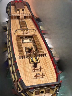

Ahoy! The pilot's cabins - part 10 of the Montañés Build
And also some new photos from my current state IMG_1617.jpegIMG_1632.jpegIMG_1615.jpeg02C4D454-DFF1-4CC6-91A2-F749533F04B7.jpeg

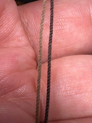

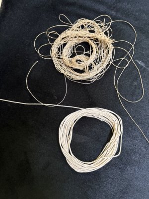

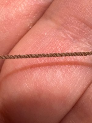

And my very first own ropes made with my ropewalk machine . After some trails and errors,but still there are much to learn IMG_1629.jpeg

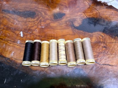

I know, don't worry haha. If you find that one perfect color, next one you find will be even better. Just remember that if you choose wrong, it hurts a lot in the middle of work, its feeling that you don't want to continue or don't want to do it again from beginning, is very problematic. It's better to choose this color good and effectively. My perfect one, ever. Maybe...20231008_172848.jpg
I know, don't worry haha. If you find that one perfect color, next one you find will be even better. Just remember that if you choose wrong, it hurts a lot in the middle of work, its feeling that you don't want to continue or don't want to do it again from beginning, is very problematic. It's better to choose this color good and effectively. My perfect one, ever. Maybe...View attachment 517876
It's looks so good
What is the thread brand and color ?
It's looks so good
Its Gutermann Mara col.263 "beige" for running rigging.
I try also col.697 "dark brown" for standing rigging, and col.999 "black" for tannin spots.
Interesting colors are also col. 696 "chocolate brown"and col.453 "warm beige" for cannons, and details rigging.
Also col.265 gold beige for standing rigging.
Problem is that the thicker it is, the more different color is, in different light color is different, and each spool from manufacturer is a different color...

Nothing new. I have these threads in size 120tex, 70tex, 30tex, others are also not available to me. First i make 3x120tec from which I have a line of about 0.10 mm, then i take 3x0.10 mm and i have about 0.4 mm and so on. Or i simply mix them by size one more inside core. Sometimes i use other threads, e.g. Polish Ariadna talia numbering ash 0916, beige 0930, black 0799, brown 0772. These are similar colors. First, try spinning any waste thread with a TEX mix of whatever thickness you want.
