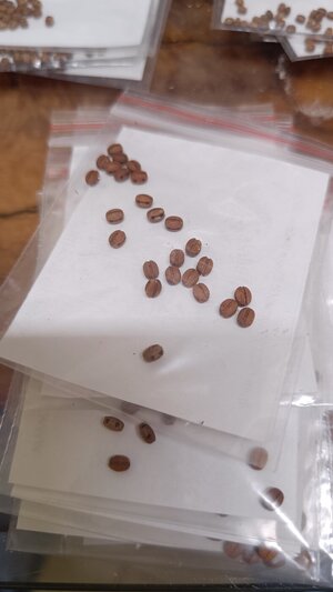

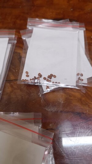

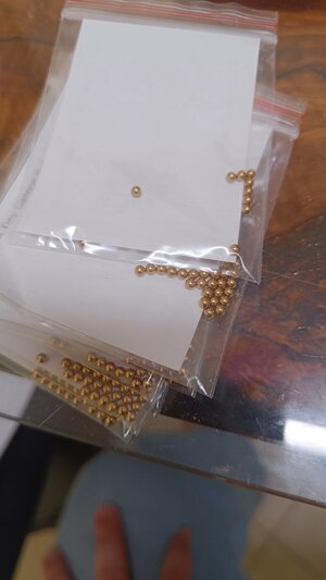

The mail came today View attachment 450939View attachment 450931View attachment 450932View attachment 450933View attachment 450934View attachment 450935View attachment 450936View attachment 450937View attachment 450938

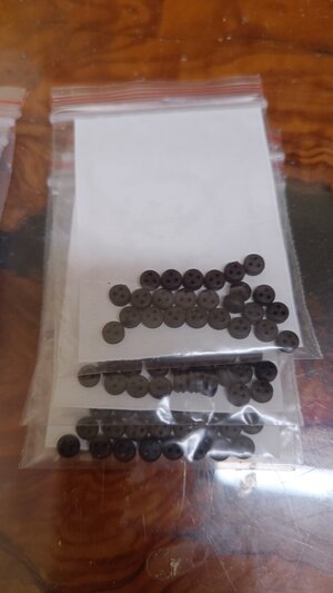

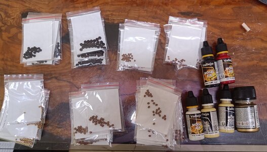

Pear wood blocks 4mm & 3mm (for the guns)
Ebony deadeyes 5 & 4 mm
and 2.5 mm brass gun balls.
vallejo ice yellow, red, black , white and liquid metal gold
Are those paints for airbrush only or can you brush it on? Have you used that brand before? I would be interested in your review of them?
Vallejo is a well known brand,excellent acrylic based paints.
There are few paint lines there the model air line specific for airbrush ready to use, and basically can also be applied by brushing the paints.
the other lines are for brushing but also can be used with airbrush after proper thinning the paint.
to comper with OCCRE's paints
those are superior with lare paint catalog.
also good company with acrylic paintints are Ammo MIG paints and AK Paints.
I saw these paints in my local store, but I did not know they could be brushed on....I will now try them.
In general light paints like yellow and white are harder to brush.
Make tests with one dark paint and one light paint to see the outcome and how thy behave.
Good luck.

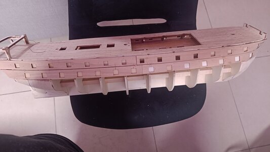

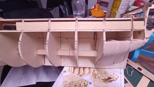

I whanted to finish few things for this update.

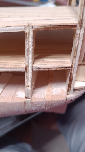

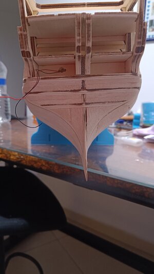

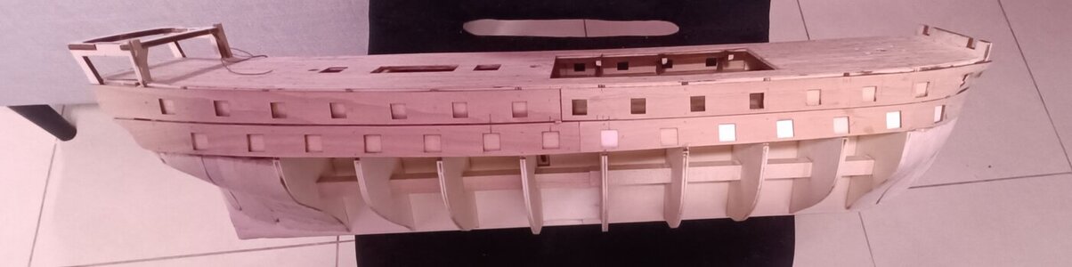

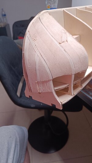

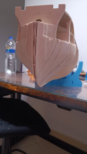

In This build i decided to invest in more prep time for the hall so baow and stern filled with balsa wood to support the planks and for easy planking.

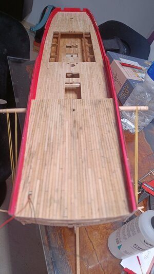

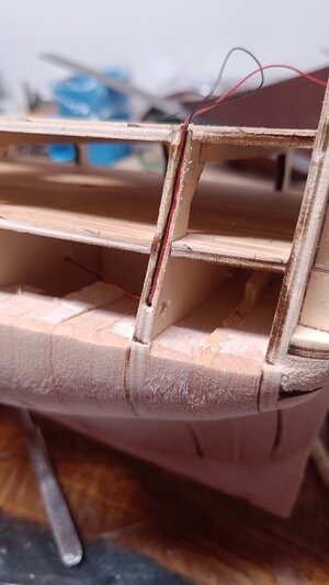

And i decided also to change the wire location for the stern wiring IMG20240601194635.jpgIMG20240601201856.jpg

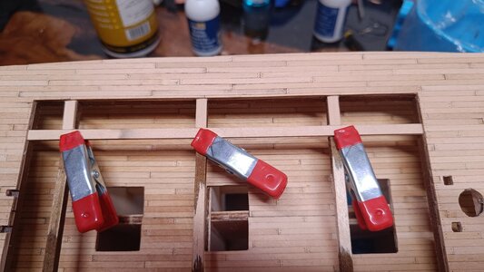

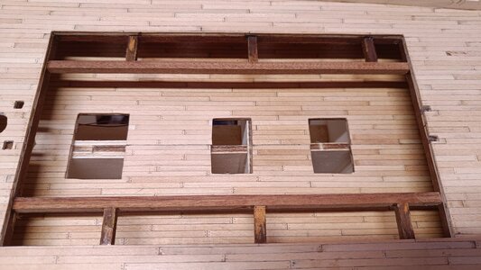

Next is the greating on the Quarterdeck deck, for now it only the beams , the pillars will be added only after the guns placment.
Next are the gun ports
taking also care on them, making sure that the ports align are more accurate.
I also made plankin on the open waist deck gun ports fro the inside
For the fore castle gunports i added a 3rd gun port.
taking measurements for the position.and opening the hatch.IMG_20240611_095852.jpg
And completed with all the gunports

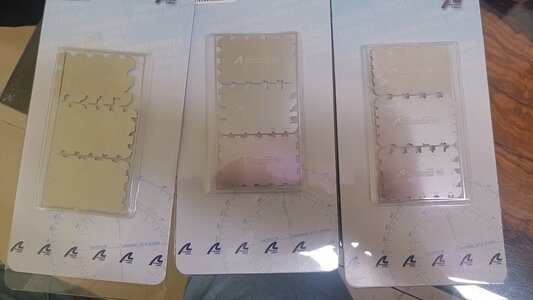

And my last tools addition, the AL micro shapers sets, very hard to get the the three sets all together together close to the MSRP price and and a store that willing to ship to Israel with reasonable shipping cost. (the store sent with EMS :mad:)

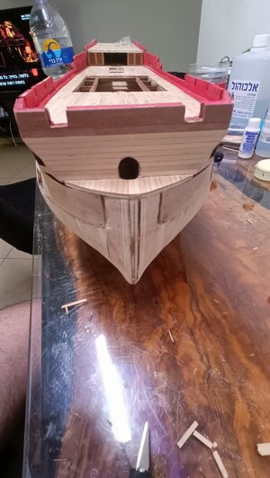

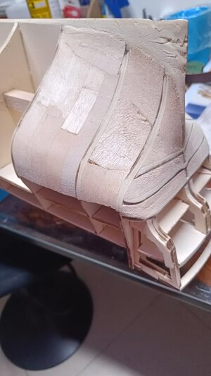

Long time...
View attachment 452700View attachment 452701View attachment 452702View attachment 452703
And i decided also to change the wire location for the stern wiring View attachment 452704View attachment 452705

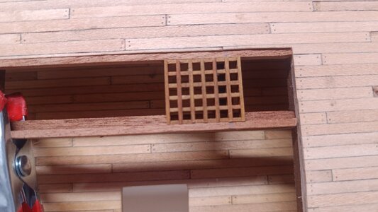

View attachment 452706View attachment 452707View attachment 452708View attachment 452719

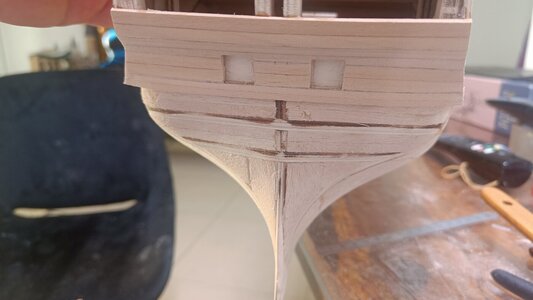

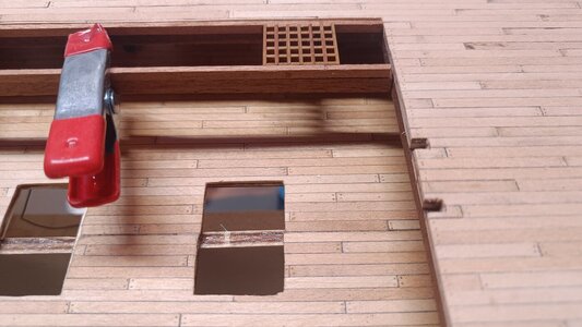

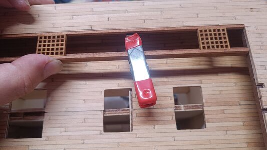

taking measurements for the position.and opening the hatch.View attachment 452723
Till next time Cheers
Guy
Good afternoon Guy. Those fillers and the hull fairing is looking very good. Will certainly make the planking easier and ensure perfect symmetry. Cheers Grant

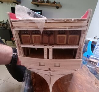

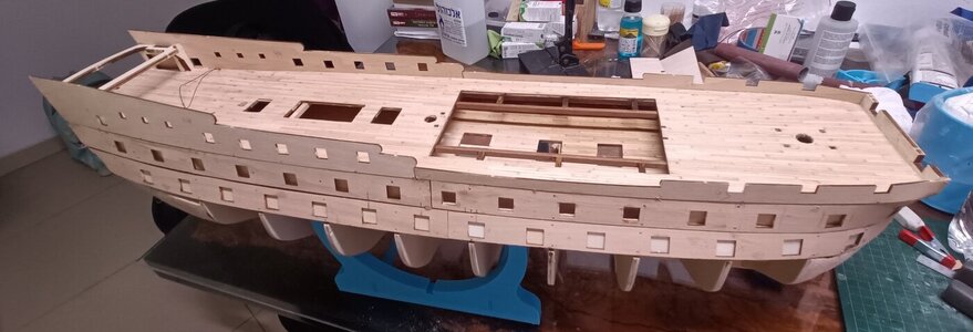

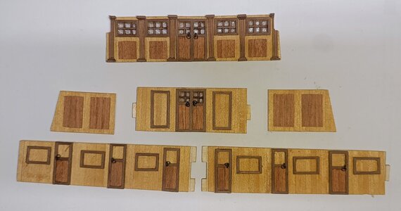

After intensive 3 weeks of work

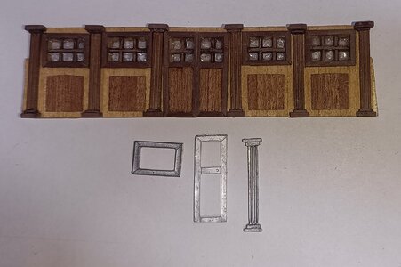

I have finished to make the pices of the officers gallery quarters.
All redone from walnut wood and the
pillars i made with the AL micro shapers and the windows are made with micro kristal klear.

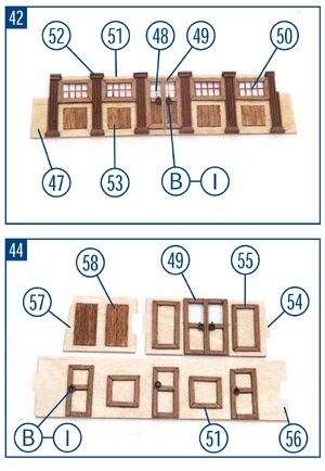

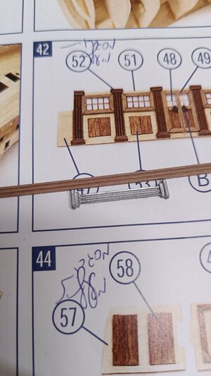

The instructions result
My result
I didn't make an actual windows deliberately because there will not be LEDS,only in the rear of the gallery.
Next update after completing all the gallery deck.
Cheers
Guy
View attachment 455475View attachment 455476
My result

Good morning Guy. Lovely. I am impressed with the scraping of the pattern into your walnut pillars. I find walnut very soft and it does not hold the pattern as well as harder woods. You got your really good so kudos. Cheers Grant
Thank you.

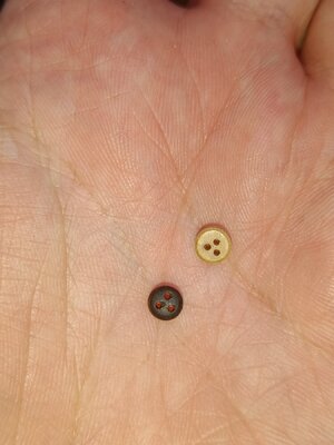

The pattern making wasn't so difficult as the holes for the handles , on the doors.
Much more trickier with multiple drill bits to prevent the wood from splitting with this wood thickness.

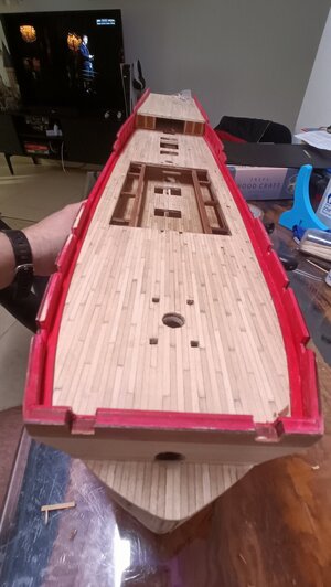

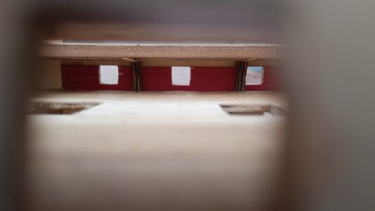

Phase 1 completed took me about 2 month to finish .
The ship is finally ready to the hull planking almost only some exterior finishes on the exterior gun ports and then planking.
Phase 2 will be the hull planking , the hull coppering and the gunports.
