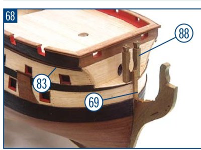

After two weeks of vacation and few days of working,i finally finished the the hull.
Now the ship ready for the painting and afterwards the coppering.
while placing the keel,post stern and stem i encountered small location proble.
the post stern has is exact location.
the steam was little bit tricker.
With the instruction illustration showing this diagram for placing the stem.
I used this illustration to set the position of the stem using the vertical prolongation and the knighthead more accurately.
And TA-DAAAAA !
Well,
lucky me it's all going to be covered with copper plates...
And the final result.
So till the next problem or issue
Live long and prosper
