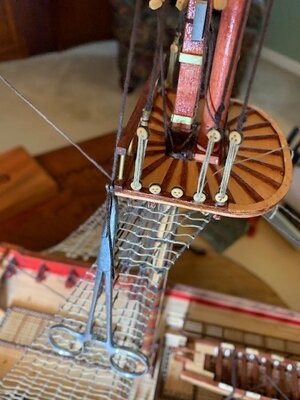

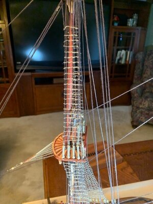

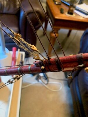

Weekly Update - slogging through rat lines
Not to be utterly boring but rat lines are time consuming for sure. Over the next couple of days I'll finish the main mast then I'll put up the outer stays. Mizzen mast is last. I will be happy for sure to finish this off.
Still waiting for the beeswax from Model Expo. So in the mean time here is what I am doing. I take a long thread (3 meters at least) and hit it with a mix of about 40:60 white glue and water. It dries fast. I then cut a section, attach a weight to one end then hit it with a quick swipe of flame to clear off any remaining fuzz. It works well. Once I get enough courage I'll work on some of the lines that are already on the boat.
Couple of pics below.
Aug 31 pic 2.jpgAug 31 starting the last set of rat lines on the main mast pic 4.jpgAug 31 upper rat lines for the main mast pic 3.jpg

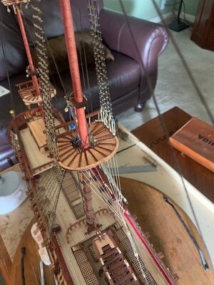

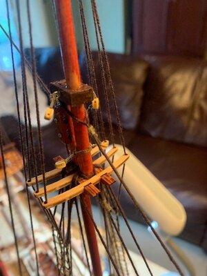

Weekly update - finally completed the main mast rat lines and standing rigging (almost)
Took the holiday off and visited some relatives clear over in Gunnison Colorado. Did some golfing with my newly constructed shoulder. Amazingly, no pain. but I am way out of practice. my first round was a 109 with my second round being 100. I blew it on the last couple of holes. The good news is that I believe I'll be back to shooting in the 80's with only a few more rounds of practice.
Back to the boat. I have finally finished all rat lines and shrouds for the main mast. I just have a couple of outer stays left to do, which I will tackle this evening.
Here is my report on reducing fuzz. Beeswax is clearly the best. Even so I found that it was best to burn off the initial fuzz with a lighter flame first. Since I dried many anti fuzz methods I figured I'd list my results
  • Candle wax works but it can leave some "candle dust". Burn off the fuzz, apply the wax, melt with wax with a blow drier. Indeed the knots seem to really lock in when you tighten them
  • Mixes of glue and water. After burning off the fuzz I found that the string is indeed fuzz free but it's ..... brittle. if the glue water mix is too low I found that I had a fuzz issue. So it's a tad hard to work with.
  • Combo of candle wax and glue works very well sans the candle dust
  • Beeswax works best for sure. Burn off the fuzz then apply. I tried the blow drier on it but no need. The only thing I am worried about is will it indeed attract dust.
I will start the mizzen mast tomorrow (beeswax only). This evening I'll attach the final outer stays. I will be good to finally get past this phase.
Have a nice day everyone.
Photos below.
Sep 7 pic 1.jpgSep 7 pic 2.jpgSep 7 pic 3 Flaming off the fuzz.jpgSep 7 pic 4 overall boat.jpgSep 7 pic 5.jpgSep 7 pic 6 upper part of the main mast.jpgSep 7 pic 7 top of main mast.jpgSep 7 pic 8 upper rat lines on the main mast completed.jpg

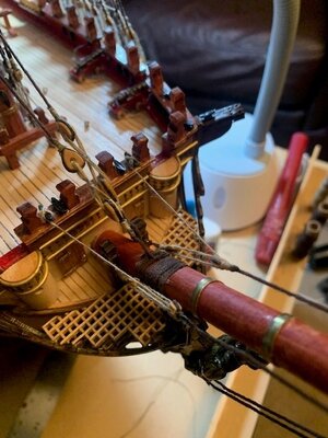

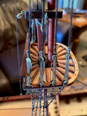

Weekly update - so close to finishing the standing rigging I can almost taste it.
I started this stuff around mid July and it looks like I'll have it wrapped up mid Sept. Two solid months!! sheesh.
Tonight the objective is to complete the rat lines on the starboard side of the upper mizzen mast, Port side tomorrow, then the final outer stays Wednesday and Thursday.
At this point I will stop with the rigging and yards etc and take a few weeks to clean up things that need to get done on the boat proper. Need to get the cannon door lines done, got some window grating to clean up and a few other bits.
Couple pics below.

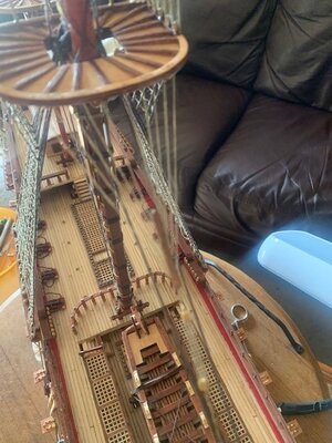

Couple pics below.
View attachment 256030View attachment 256031View attachment 256032
