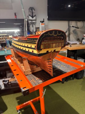

Finally at a point for another update. The copper plating is completed and I have painted the upper parts of the hull.
I have a couple more cleanup passes on the paint, then I intend to put on a satin finish topcoat.
I am still undecided how to leave the copper plates. Do I leave natural and let oxidize on it's own, do I put on a clear topcoat to try and keep new and shiny or do I use some patina acid and green it up???? I would appreciate any thoughts on this.
After cleaning up the pain, I plan to move on and start to build out the bow and stern.

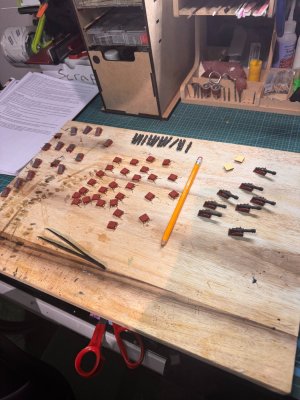

Here are a couple more pics of where I completed the bow and then started work on the deck...adding grates, rails, bell tower and cabins.
Then I started with building things for the deck.
View attachment 485469View attachment 485467View attachment 485466
View attachment 485471View attachment 485470
Next I began working on stern.
View attachment 477498View attachment 477499View attachment 477500View attachment 477501View attachment 477502

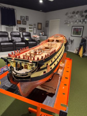

Ok, I have an update before the holidays. I cleaned up the hull and put a satin coat finish on it. I also completed most of the addons to the deck and put a satin finish coat on that as well.
And now I am going to move on to the gunports and cannons.
I hope everyone has a happy holiday!!!!!!!
View attachment 491337View attachment 491336View attachment 491335
View attachment 491334View attachment 491333View attachment 491332
View attachment 491331View attachment 491330

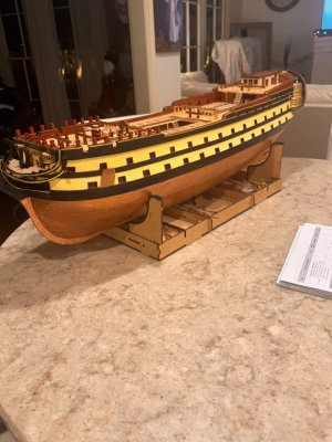

Good morning Gene. Looking mighty impressive. Nice!! Merry Christmas . Cheers Grant
Hi Gene,

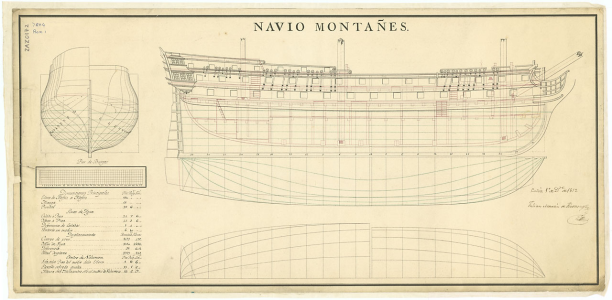

I am curious about the line of the hull planking, hope you don't mind. Is there a reason you have the planking, including the wales, following the sheer of the decks? I have not seen this done on contemporary plans or models so it struck me as unusual. Thanks
The plan below from Museo Naval in Madrid shows how the line of the planking has no correlation to the line of the gunports and corresponding deck beams.
Hey Allan, I try and build my models more for display and appearance and not for historical representations. When I come to a crossroad or decision point, I will usually opt for what I think looks better. You will also note that my coppering does not follow the true waterline especially on the stern as I have it following the curve of the wood. I imagined I would get some questions on that decision from some forum members, but when family and friends look at the model, they think it is natural to have the plates follow the wood.
