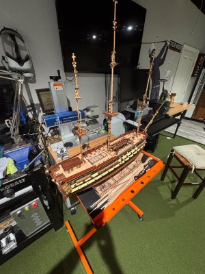

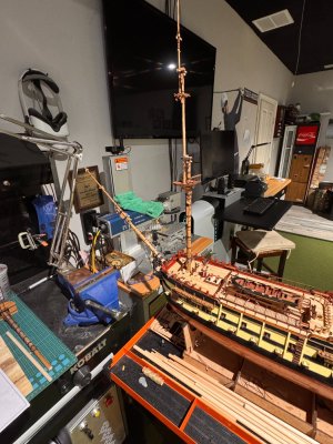

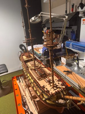

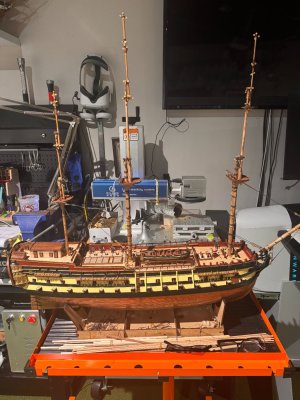

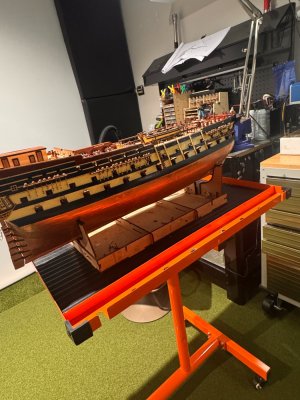

OK....90 deadeys assembled and installed. Whew!!!! The Occre plans call for the deadeyes to be wrapped in wire which I really did not like so I called an audible and assembled what I think is more realistic. I wrapped the deadeyes in rope and threaded them through the boards and then used wire to fasten them to the ship via brass hooks. I think they came out looking nice....but you guys can judge from the pictures below.
I am now officially moving on to masts and rigging......it's been a long journey so far, but I feel like I can see light at the end of the tunnel.
