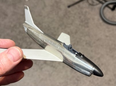

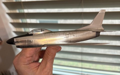

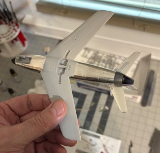

And you may have noticed I started painting the fuselage nose cone. But I applied some real metal film on a few panels to see what it would look like. It’s super thin aluminum foil with self adhesive on one side.
And it looks like real metal because it is! ;)
And this is as far as I got…tedious work for sure!

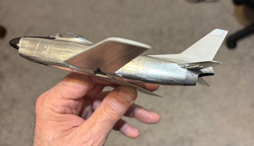

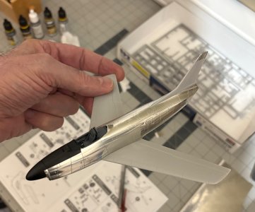

Progress is slow and methodical. I am looking at strategic application of panels.
First I measure and make a piece large enough to go a little past the panel or panels I am going to cover. Then I attach one side first and carefully press it around the contour of the aircraft. Once fully down, I burnish it with a q-tip to ensure it’s pressed down well. Then I trim the profile of the panel with an xacto knife. The pressure is very light on the blade. Then I remove the excess around the panel.

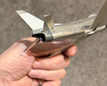

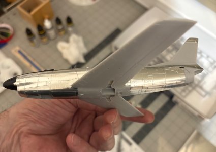

Then I made tools for the detail. I have a toothpick angle cut to have a thin round edge for panel lines, and one that has a sharp point for rivets. I use these to press the material into those features…
Some areas are tricky, like at the wing root on the leading edge…

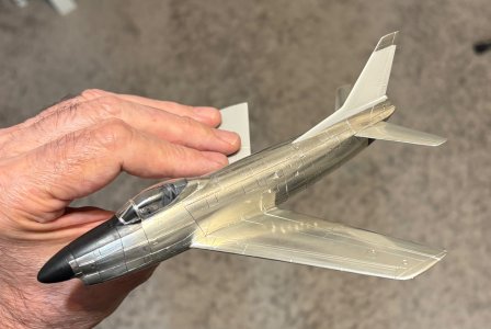

I'm going to have to add your metalizing technique to my toolbox. Great modeling Dean!
Thanks Daniel!
I have found the key to success is to only apply small sections at a time and trim to the panels on the aircraft. It is so thin that large pieces will stretch and even wrinkle, sometimes just removing them from the backing.

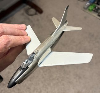

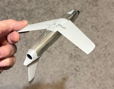

Update…
Canopy on, elevators on…exhaust panels painted. Next will be the wings…

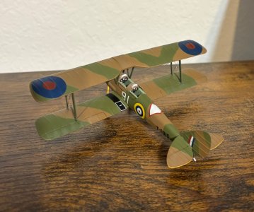

From time to time, I grab an airplane off the shelf and add a detail or make a change for the best. Today the Tigermoth was needing my attention. The old rigging was a bit out of scale. Now with the EZline rigging I have, there is no excuse. So I removed all the rigging and added it back with EZline. And she looks more to scale now. ;)

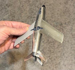

On the F-86D Sabre, I am waiting on the rest of my Bare-Metal aluminum I ordered to arrive, but will start painting the landing gear and other pieces that will go on.
I’m down to one wing before I can start adding the landing gear and decals. I’m still waiting for the Bare-Metal I ordered to arrive…sigh.
So I started the painting on the landing gear parts and doors. If I get all the parts painted, then once the things I ordered arrive, I can finish it in a day. ;) Looking forward to seeing her finished!

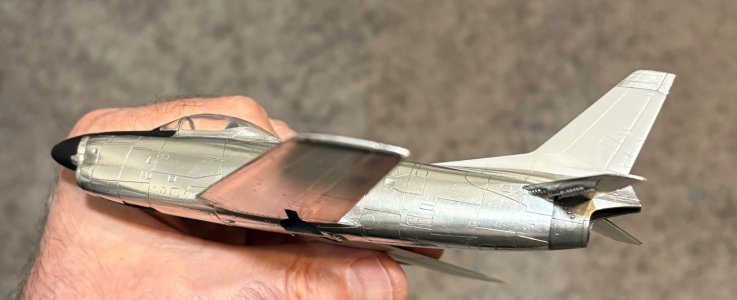

I'm amazed at how smooth and wrinkle-free you can get that foil, especially on such large areas. Just beautiful! Have you ever had any issues with the adhesive failing over time and the foil starting to peel at the edges?
