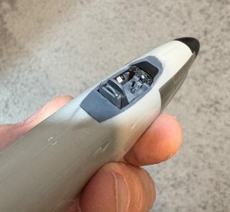

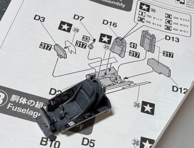

I started my F-86D Sabre, one of my favorites. It’s a Hasegawa kit.
First was the cockpit assembly…

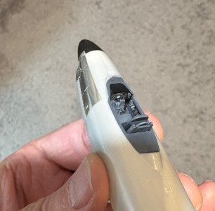

Not a lot of detail, they use decals to simulate the control panels. Then after completing the other sub assemblies I joined the fuselage halves…
Its looks ok for 1/72 scale.

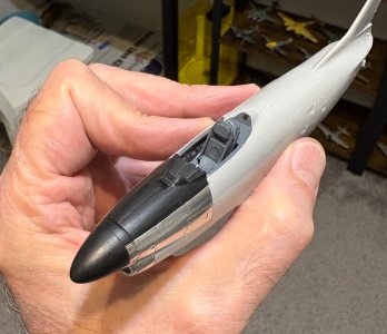

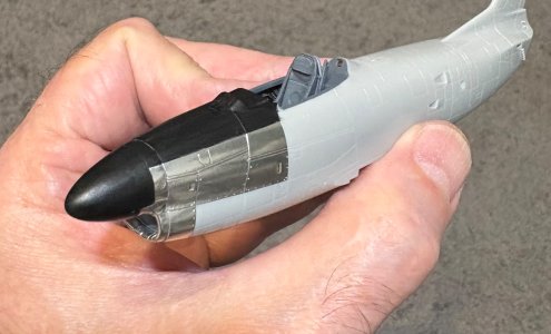

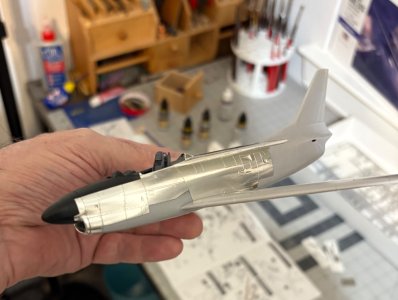

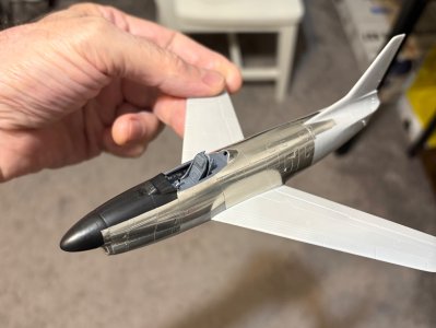

And you may have noticed I started painting the fuselage nose cone. But I applied some real metal film on a few panels to see what it would look like. It’s super thin aluminum foil with self adhesive on one side.
And it looks like real metal because it is! ;)
And this is as far as I got…tedious work for sure!

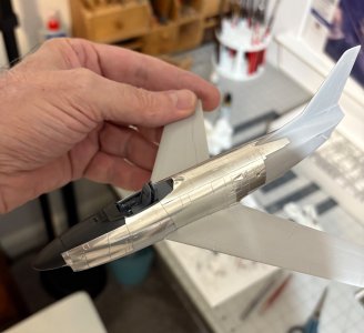

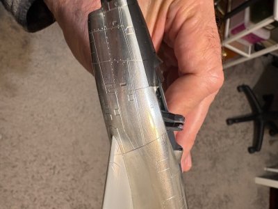

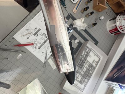

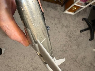

Progress is slow and methodical. I am looking at strategic application of panels.
First I measure and make a piece large enough to go a little past the panel or panels I am going to cover. Then I attach one side first and carefully press it around the contour of the aircraft. Once fully down, I burnish it with a q-tip to ensure it’s pressed down well. Then I trim the profile of the panel with an xacto knife. The pressure is very light on the blade. Then I remove the excess around the panel.

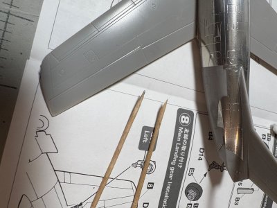

Then I made tools for the detail. I have a toothpick angle cut to have a thin round edge for panel lines, and one that has a sharp point for rivets. I use these to press the material into those features…

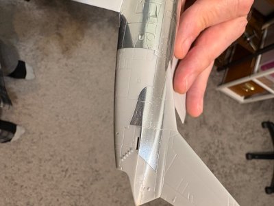

Some areas are tricky, like at the wing root on the leading edge…
Anyway, I ordered another sheet today as I’m running out…sigh!

I'm going to have to add your metalizing technique to my toolbox. Great modeling Dean!
Thanks Daniel!
I have found the key to success is to only apply small sections at a time and trim to the panels on the aircraft. It is so thin that large pieces will stretch and even wrinkle, sometimes just removing them from the backing.
