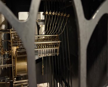

I installed the movement, and the clock face and side panels. Then I installed the back panel with the chimes. Then I hung the weights and pendulum so I could set up the clock.
IMG_0036.jpegThen I adjusted the hammers to be centered on the chimes and started the clock to test everything.
Next I have to hang the door and install all the glass and panels.

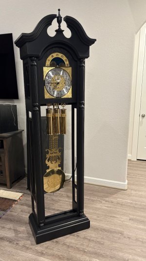

This was built from plans. Then I had to order a movement, clock face, weights, pendulum, glass, hardware, etc. I probably spent over $1,000 just in components alone! But one this nice would cost 3 to 4 times that much.
I always wanted to build one, it was on my bucket list…ROTF
So about 5 years ago I did all the wood working and built the main enclosure, door, block panels and back panels. Then I stained it. My wife didn’t like the color stain I used…sigh! So it took the wind out of my sails thinking about sanding it and redoing the stain. Many years later after threats, I decided to paint it. And black and gold look classy together IMO, so I bought paint and started putting coats on all the wood pieces.
So…it looks like I will finally put this project behind me soon. ;)

Now I am totally blown away! Your joinery and craftsmanship are immaculate. Routing ogees on the curved head pieces is no easy task. Your miters are perfect!
And then there's the split-turned columns - with fluting no less. Not to mention the finial. Wow. We're not worthy! It's really a shame about the stain. I love to see the beauty of the wood figure. The black, however, was an excellent choice.
I work in a furniture factory. If you ever want to get out of Houston (like I did) and move to the Finger Lakes where there are actually seasons and you can't drive 20 minutes without running into a lake, let me know - you'll have a job waiting for you here!

I have a router table and I made jigs to ensure proper heights of my raised panel cutters so they are repeatable. However I typically try to do all the cuts with one blade on all pieces prior to switching. With a table saw, miter saw and router I did most of it. There are a few exceptions…where sanders, drills, etc. came into play. My uncle has a lathe and he turned the columns for me. I have no experience in that area. ;) So I credit him for those gems! I just cut them in half…which was scary! ;)

Absolutely gorgeous. The contrast of clock and walls is very pleasing to the eye.
Thanks Daniel!
Great! Well done with this ‘over the years’ project, Dean. Now let's get used to the new sounds and melodies in the house.
It plays three different tunes and also has a silent mode for the evening. I made sure to get a nice movement (HERMLE), as it is the most important piece! ;)
