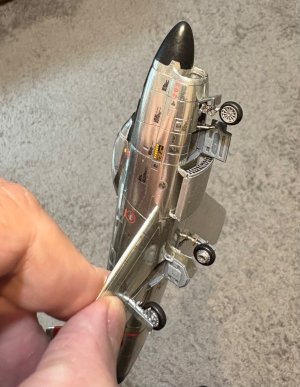

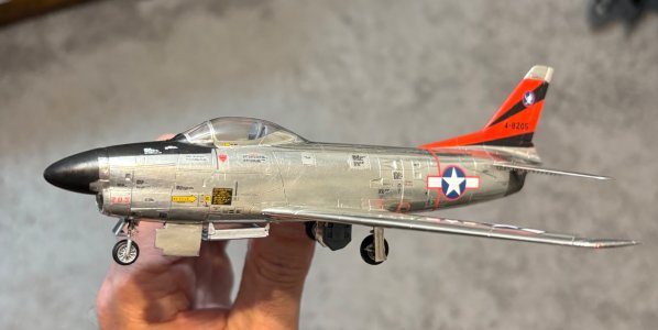

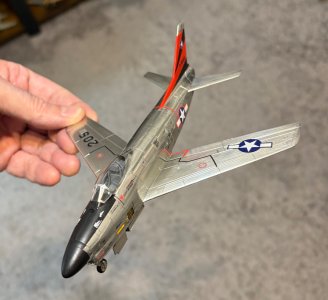

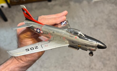

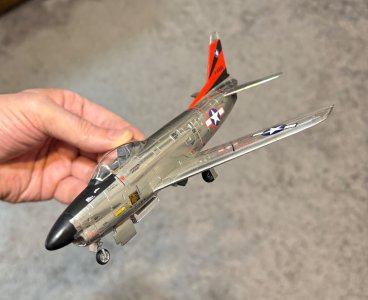

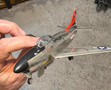

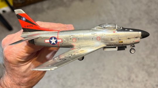

Finally finished the F-86D Sabre Dog!
Because I chose to cover it with Bare-Metal instead of painting it, that cost me an extra week of time. That and running out and having to wait for my order of more.
Anyway, I painted the tail and finished the decals. So even though this build was longer than anticipated, I am still happy with the end result.
IMG_1167.jpegIMG_1168.jpegIMG_1169.jpegIMG_1170.jpegIMG_1171.jpegIMG_1172.jpegIMG_1173.jpeg
I put some matte varnish on a few panels here and there for realism.

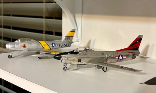

And here it is next to my F-86 Sabre…I really love the nose on the D version.

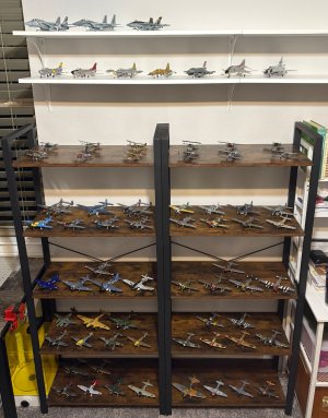

Now I have 10 jets built, and 70 aircraft total finished.
I added another row of shelves for future additions. ;)
Thanks for your interest and input. I am deciding what’s next…I have enjoyed switching to jets for a while. However my Mosquito is waiting. ;)

Your Saber Dog looks great.
Now that you have the two kits next to each other, I never noticed the slight difference in the back of the canopy between the two models of Saber. :)

Thank you! The tail and especially the elevators are different as well. Most noticeable difference being the nose.
The F-86D Sabre is one of my favorites of the early jets.
