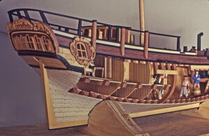

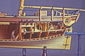

As far as cutaway ships, I just finished (last month) a cutaway of the Soleil Royal. You can see the log here: https://shipsofscale.com/sosforums/threads/mantua-sergal-soleil-royal-cutaway.5120/

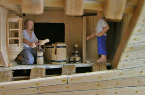

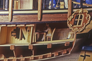

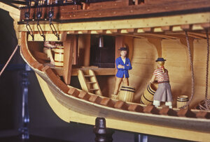

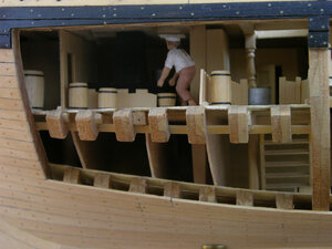

That's not what I'm looking for. I just want a 'hole' in the side of the ship displaying some of the innards.
