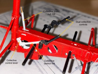

The first set of controls I need to be building is the collective pitch control of the main blades, since part of the system is housed inside the torsion box. I need this system in place in order to be able to close the torsion box, which in turn is needed to be closed to allow installation of the floor, seats and instrument panel. With me so far?
I have two drawings helping me out with respect to the collective controls on/in the torsion box. Upfront I'll tell you I will be deviating from these drawings, just to make it work...
Below, encircled in red, is the collective pitch control system.
And here an assembly drawing of the collective control, with the pushrods and levers, ultimately driving the control rod, attaching to the rotor head
After a few days of fiddling and playing around a little bit, I came out with this:
It's a dry fit, so not everything is aligned properly, but this was just to ensure the fit and functionality of this part of the collective control system. The push rod nicely clears the shaft for the pilot seat support.

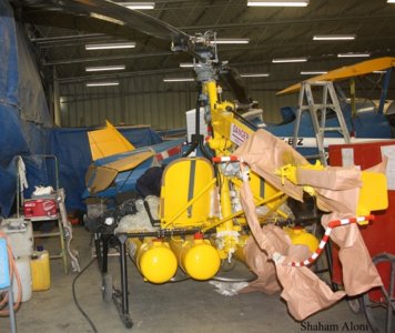

In 1985, upon the expiration of the contract with IAI, the helicopter was transferred to the Air Force Museum in Hatzerim. The museum's commander, Yaakov Turner, accepted Jerry's request to store the helicopter in the museum, even though he was never a member of the Air Force's staff. The second surviving Hummingbird H-3 in the world is currently on loan from the Aviodrome museum (located at Lelystad Airport) to the Air- and War Museum on the island of Texel.
In the early 1990s, Jerry Renov's Hummingbird was removed from the Air Force Museum in a rather dilapidated condition. Although the Hummingbird was considered an efficient helicopter in terms of its performance in the field of agricultural spraying (it was a large consumer of fuel, 200 liters of fuel versus 200 liters of spray liquid!), it operated in the agricultural service for a very short period, less than seven consecutive years, and its operation was discontinued mainly because Jerry was an excellent pilot but a poor businessman, and was unable to operate his helicopters with the required profitability.
The remains of the helicopter were found at the “Avirom” company at the Herzliya airport.
At a scrapyard in Herzliya Airport, the helicopter was refurbished for display at the “Avirom” company, and it was marked with the original Dutch civil registration markings.
The Hummingbird after the renovation at “Avirom".
(Photos: Shaham Aloni)"

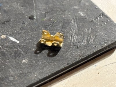

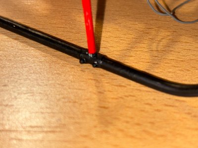

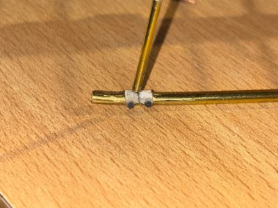

I got some feedback from @Peter Voogt on the parts at the skid/strut interface. This led to the use of easy plyable material, which in turn led to an acceptable solution to a persistent issue.
Here the detail at the skid/strut interfac, based on Peter's help on this part:
(I also used dummy bolt heads on this interface)
Below one of the may failed attempts of brass made parts. I both used flat patterns and tube to get it right, but it all ended in failures (the part has a length of 6mm and an outer dia of 3,5mm):

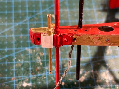

Here the skid/strut interface with finish applied:
After having successfully tackled the previous issue, it was high time to continue work on the completion of the collective controls, which would allow me to (finally) close the torsion box.

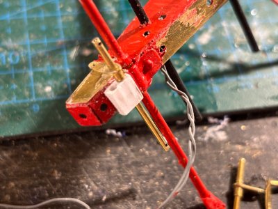

I first needed to have the RH collective control assembly and the collective push/pull control rod assembly installed, before attempting to install the LH side wall. This took quite some fiddling before everything lined up properly. If I were to attempt a second build, I would certainly forego the installation of lightsnand working controls; these ideas resulted in really complex build sequences.
Once having completed the torsion box assembly, I could now add the second (LH) collective control. I added an undocumented support, extending from the seat support beam, for the control shaft, for improved robustness.
The collective push/pull rod is split. Having a full length rod would be impossible to install, plus I don't yet know the exact length of this rod. The (unpainted) pin allows for a (later) male/female type connection.
A picture showing the current status of the fuselage assembly:

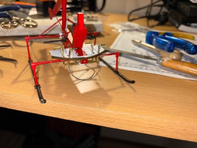

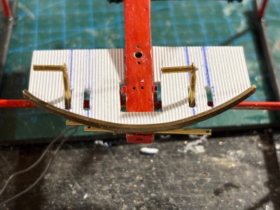

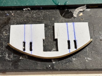

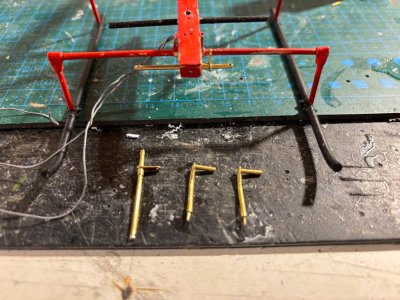

After having installed the collective controls and closed the torsion box, I changed my focus to the cockpit floor and the tail rotor controls. The four rudder pedals protrude through the floor and connect to two parallel shafts. On each shaft a lever is present, to which a control rod is attached. This control rod is then attached to another lever system in the main mast.
The cockpit floor is made from Evergreen ribbed sheet. It's left over material from my Fokker Spin build, which is now being put to good use. The forward edge of the floor is reinforced with a brass u-section; the Evergreen sheet is rather flimsy, when unsupported. Below a picture of the raw cut floor with the cut-outs for the rudder pedals:
In order to have a robust support for the two pedal shafts, I crafted a block with two dia 1.6mm holes, 2.5mm apart.
The two pictures below show this block with one of the shafts installed:

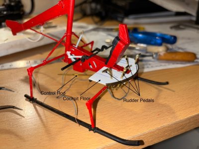

The next picture shows the helicopter's fuselage with one of the shafts installed and in front of the helicopter the second shaft and two of the four pedals:
First dry fit of the floor and the rudder/tail rotor control system:
Fast forward a day and the second set of pedals have been made and the RH control rod. It's all a temporary fit, still a lot of work is needed to tidy it all up.
One of the issues I'm now encountering is to find the proper build sequence. Since a lot of parts need to share the same space, it's unavoidable to encounter sequence issues, for instance the fwd tank attachments occupy the fwd traverse landing gear spar. The floor with the rudder controls sit directly above the fwd spar. Installing the floor first results in limited access to the tank installation and vice versa. I guess I need a night's sleep over it...
