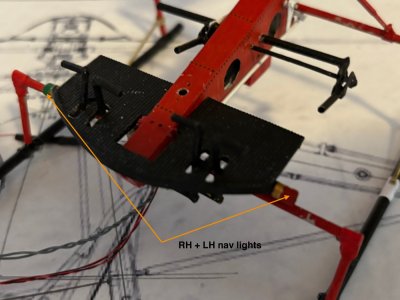

I added the two LH- and RH nav lights, see picture below. I used clear acrylic tube for the housing of the lights and brass tube for the lamp fitting. The housing of the lights are painted in the appropriate colors.
The routing of the wires is also coming together: the wires will run below the floor towards he RH center tank, which also houses the light switch. There is unfortunately very little space to a) connect the wires and b) stow the surplus wires in the RH center fuel tank. Still something to pay attention to.

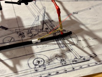

Another tiny detail which still needed to be added were the struts, connecting the skids to the aft cross beam legs. Additional detailing is still required for the wheels attachment, also a lot of touch up is needed...Sick

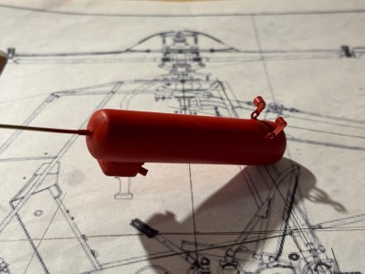

Finally, after dragging my feet for months on end, I could no longer avoid to try and use the airbrush. @Peter Voogt gifted me an airbrush, minus compressor, and after buying a low cost compressor, I postponed any activities concerning using the airbrush for as long as I could. Now getting close to the point where I have to install the fuel tanks I had to start learn ng to use the airbrush.
Below two pictures of one of the fuel tanks after two layers of paint. Not perfect, but I think it's close enough for an airbrush rookie:

I really thought I was heading towards a disaster airbrush job, but in the end the results are way better than any paint job by hand,at least when I do the hand painting.
And indeed, applying the paint with an airbrush is not very time consuming, but especially the aftermath is rather time consuming...

That's looking very nice, Johan. And for using an airbrush, it's practice ........ practice ......... practice. But this is looking very promising.
The air brush on the fuel tanks looks great Johan. I have found the amount of preparation and then clean up with an airbrush way exceeds the actual spraying time which to me is the only drawback.
That’s my complaint with an airbrush, if you don’t have much to paint, then it’s hard to justify using it. I have become very good at painting small objects with no brush marks. It requires multiple thin coats, so I’m not sure that you’re really saving any effort or time, but definitely less messy.
I fully agree with Daniel and Dean. I mostly collected items so I can spray more efficiently. For cleaning I have the Vallejo Premium Cleaner and ..... the most hottest water my installation can give.

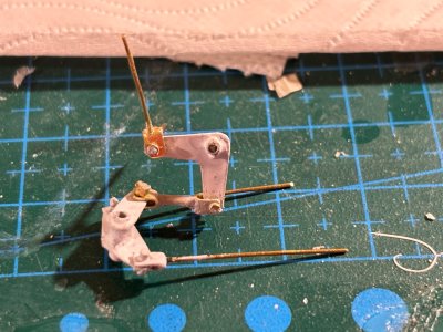

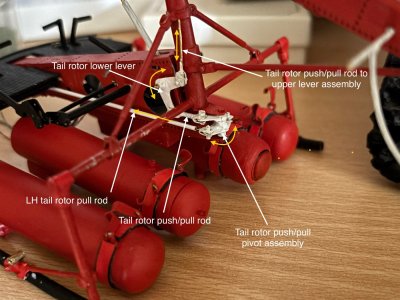

Finally I was able to complete the aft pivot assembly of the tail rotor controls. To drive the entire system, the pilot either steps on the right or left pedal, which in turn, through the pull rod, rotates the aft pivot assembly. The top lever of the pivot assembly drives a push/pull rod, rotating the lower lever assembly. This results in the tail rotor push pull rod to move up or down. It's not the complete system yet, quite a few more parts and assemblies need to be fabricated, before I can call the tail rotor drive system completed.

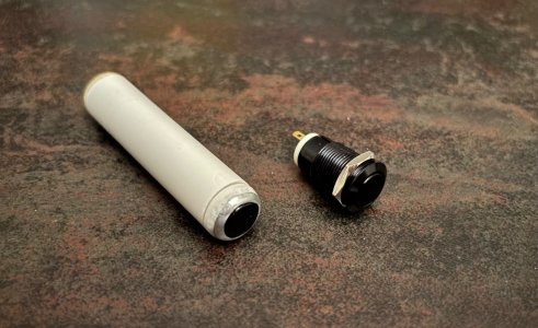

As a test, I equipped the RH center tank, which houses the lighting switch, with a soft stop (silicone) which I normally use on cabinet or kitchen doors to stop wear and tear or scratches. It does look surprisingly good, at least when compared to the original configuration.
It still doesn't match the other three tanks, but is looking way better than it did...
Unpainted RH center tank, unpainted, with switch installed, but without the silicone end piece.

In real in scale 1:1 it’s a complex part rods and pivot points. In your scale even more, Johan. And it’s functional! Just a. Big WOW. And a clever solution for the switch.
