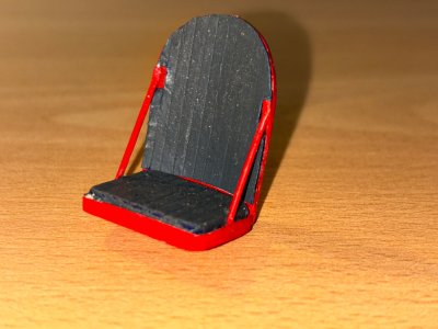

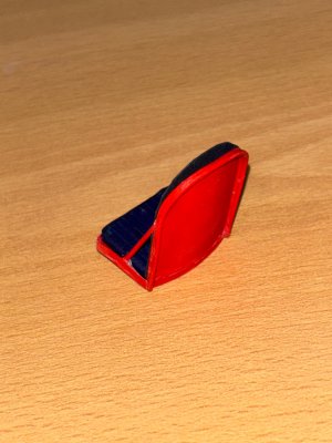

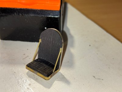

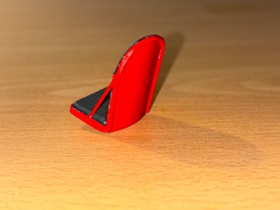

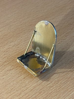

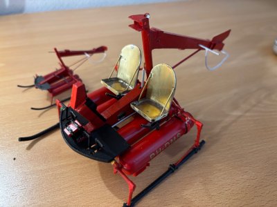

Seats moved along nicely. In hindsight I could have made other choices in how to split up the various parts, but what's done is done.
Seats and back rests are joined together, no no more soldering, but good old CA. Braces were also added and after everything was set, I did a dry fit. Those seats sure look good!
Semi completed seat:
Dry-fit of seats in model:
Looks nice, Johan. Waiting for some nice leather cushion's.
A nice basic pilot chair, Johan. Not as comfortable as in the Business Class, but ok for the pilot.

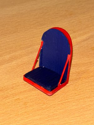

And about the process …….. you raised the curtain a bit …….. ;)
The seat is very rudimentary and certainly not designed with comfort in mind.
(The seat is composed of 2mm polystyreen sheet, wrapped with masking tape and marked with a razor blade.The backside is black paper, also marked with a razor blade.)
I'm still not convinced about the color, the restauratiion project in Israël saw the usage of a light brown leather, whereas historic photographic evidence suggest either dark gray or black.
It might be nice to use dark grey, rather than black, in order to give the model a less tri-colored theme.

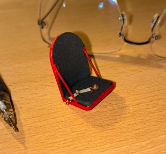

A seat in anything taken to the skies needs a harness and this hummingbird is no exception.
Now you can buy harnesses of the shelf, but hey, where's the fun in that?
After searching the internet a while for examples of scratch build harnesses, I found a few options worthwhile to pursue.
I opted for a version using ordinary masking tape, cut to size and the necessary hardware made from brass wire.
Once I made up my mind, I started working on fabricating the first parts, in order to get some experience and above all to establish whether or not this method would yield acceptable results.
The straps were made from 2mm wide pieces of masking tape and the hooks and loops, or whateveryoumightcallit, are made of 0,5mm brass wire.
Below the first strap, unfinished. I'll fabricate a complete set first, before final judgment, but that first strap looks unexpectedly good:

The dark grey looks better, Johan. And the strap with brass hard-ware looks nice, also in good contrast with the dark grey.

Your feedback was the final trigger for me to move away from the dark blue...
This first strap is exactly what I'm aiming for and it's another acquired handicraft: never too old to learn something new...
