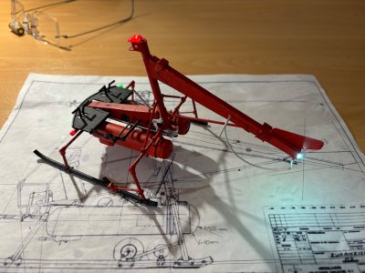

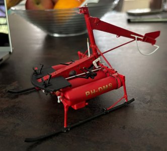

After gathering my courage, again, I decided to connect the lights through the switch to the power supply. It was quite a tedious affair; I had to and solder and temporary attach the center tanks and stow the surplus wires in the RH center tank. After a few hours I could test the lights and lo and behold, light! This also means the center tanks are permanently attached.
Below a few pictures with the center tanks installed and with lights off and on
Tanks installed:
Lights on:
And a view from below looking up:

Well done, Johan! It took some time but the light are on and the wires …….. uuh …. no wires visible.

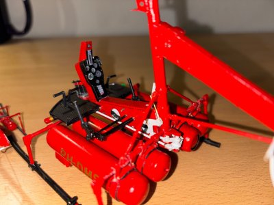

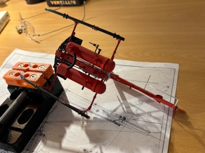

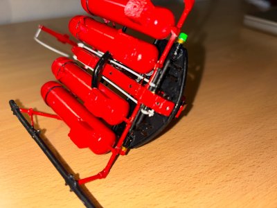

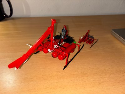

Despite the "heat wave" currently over our country (32C/90F) I booked some more progress. All four tanks are now permanently installed, as well as the instrument panel and the 6V battery. Also the system for the tail rotor pitch control is complete up till the rotor mast. Also applied two semi gloss clear coats on the tanks, center box, instrument panel and battery.
Attention has shifted towards the two seats. The first items of interest are the backrest. These are fabricated from dia 1mm frame and 0,3mm brass sheet. Tonight I soldered the frame to the backrest. The backrest still needs some TLC, but I am not entirely disappointed with the current outcome.
View looking fwd, lights on. The 1:48 monstrosity just in front of the 1:24 model.
Detail view, looking forward, with a nice view on the instrument panel, with the battery just in front of the instrument panel and a close-up view of the tail rotor pitch control system.
Before being able to complete the pivot installation I had to modify the upper pivot fitting the provide clearance to the pin in the upper lever.

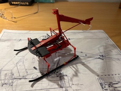

View looking up/aft. Distinguishable are the nav light installations to the bottom of the floor and the two control rods, coming from the pedals. Unfortunately, the torsion shafts are not so apparent, but, they're still there.
This last picture shows the backrest, still rather crude, dimensions 27mm by 22mm. Up next is the seat itself. Unfortunately details of the seat are very sparse, so this will require quite some AL-FI.

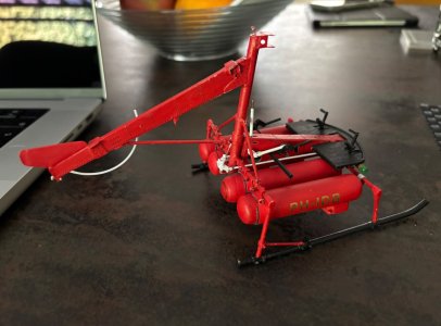

It took a long time, but now, having attached the fuel tanks, I can finally see the little hummingbird materializing. An awful lot of details still need attention, but she starts to look like her full scale grandmother.
As for the colors, mentioned by @Peter Voog, initially I was very much inclined to apply a dark blue topcoat. Not much later I realized that that would not only hide the mistakes I made reasonably well, but also the details I wanted to apply, like rivets.
Since the only surviving H-3 in the Netherlands has a red livery, the change to this color was natural. Combined with the near black for the skids and the floor assembly and the white for the flight controls this led to a remarkably well-balanced color scheme.

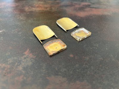

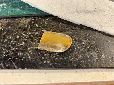

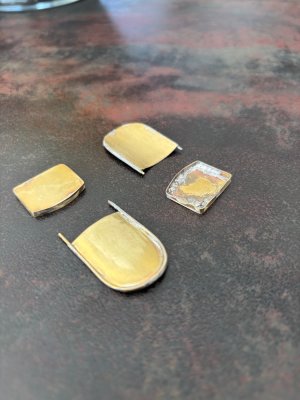

The other night I went about fabricating the parts for the seats. I now have the two backrest and the two seats.
As can be seen quite clearly, soldering is nót my forte. Luckily all my sins will be covered by cushions and fabric.
The seats are made using a small piece of brass sheet and a brass strip of approx 80mmx2mm, folded around the sheet. Soldering came next, but that exercise filled up my swear jar quite handsomely and in no time as well... TBC

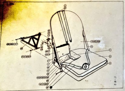

The starting points for the seats were these two pictures, again no dimensions whatsoever, so a lot of guesswork from my side:
A detail of the seat, taken from an isometric, exploded view of the helicopter:

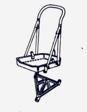

My second source is this picture, with a little more detail:
You are going into a lot of detail! Excellent. And the soldering ... I'm sure I'll need some lessons before I get to solder such parts.
Yeh, I basically can't neglect the temptation to add details. Especially the scale, 1:24, makes it possible to add some nice details. My earlier attempt on 1:48 was too small to add details.
