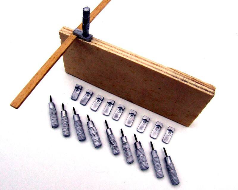

Norske Løve update: So, finally back at the workshop again after quite a long break, testing the new plank clamps. Just wish I've seen these earlier, works like a charm with pre drilling Ø1,1 - 1,2mm and a lot easier to handle than my home made clamps with slot screws.

Actually I've used two different set of clamps, one that is home-made and one that I bought from JoJo shiffsmodellbau in Germany. The clamps that I bought has the advantage of being mounted by hand, for my hand made I need a screw driver. As for the purchased ones I also completed with som simple wooden parts where it is too narrow between the planks for the metal part. First picture shows the purchased set and second picture shows one of my home made ones.

Norske Løve smaller update and a tip from the coach :). I have experienced that when I try to clamp down the plank on the most curvy part of the frames, the clamp is only putting pressure on one edge of the plank. I have tried with putting an additional piece of wood underneath the heel of the clamp and it has worked good, but is a bit cumbersome. Today though, I found a piece of 5x5mm pear wood and decided to make some new clamps with a higher heel than on the metallic ones, and it works perfect, now I have the same pressure over the whole width of the plank.

That’s a function of the distance, the radius and board thickness. So the required height is going to be different and the safe bet is more height as you learned! ;)
