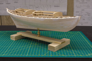

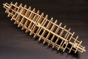

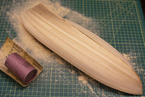

The keel was laid on the stocks in early 2020. The framing of the vessel is assembled from laser-cut plywood bulkheads Most of the blanks are of basswood - a wood that is easy to work, though harder than linden. The principles of assembly of this kit is that the modeller would be following the sequence followed by shipwrights on a real shipyard. The box is full of differently-dimensioned timber from which the modeler would build the parts. With the detailed instructions and large-scale drawings, tis is easy to do. Whoever designed the kit, did colossal preparatory work for the modelers. All that is left for the modeler is to enjoy the contruction process.

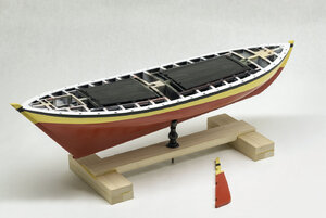

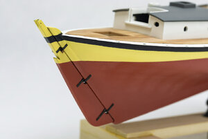

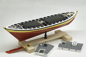

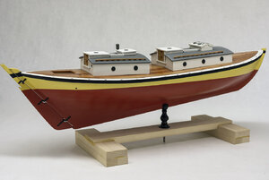

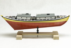

I decided to paint the hull with spray paints and matte finish:
- Rust-Oleum 282813 (citron)
- Krylon K09175000 (pimetnto)
- Krylon K09197000 (white)
- Krylon K05546007 (black)
- Krylon K09151007 (deep gray)
This is my first experience with painting models (hopefully, also my last - that's why I was in no hurry to buy an air-brush)
I sanded and painted, and sanded and painted, and sanded and painted to achieve perfect surface. I can't even count how many times I redid the yellow colour...

Yellow paint is the worst for painting.

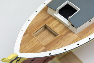

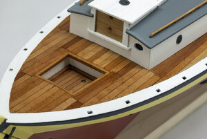

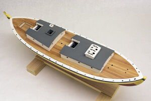

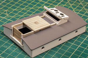

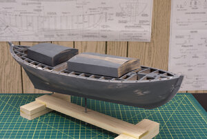

The deckhouses would be installed after the completion of the deck planking. This way, it would be easier to sand the deck and imitate the nailing pattern. Speaking of which, I decided to replace the basswood planking with pear. This deck details that will not be painted, I will make from pear also and protect them with oil. Just because I like how it looks better than the pale color of the basswood. After this is completed, I can begin work on the bulwarks.

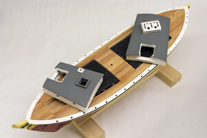

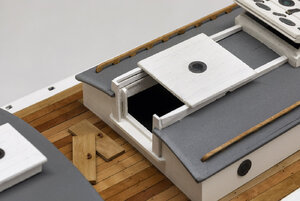

Apr 21, 2020
309
323
New London (Connecticut)

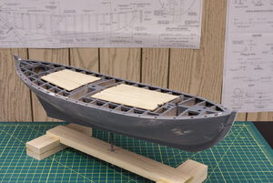

After dry-fitting the deck houses, I began gluing the deck planking with black-tinted glue to simulate the caulking. I made sure that the deck houses did not get glued to them at this stage. After completing this step, I removed the deck houses and sanded the deck with 150-grit sanding paper. I simulated nails with the help of CA glue. I marked the nails, drilled them with .35 mm drill, poured CA over this and sanded the deck for the second time (first with 150-gritt, then with fine, 400-gritt sandpaper). The CA also added definition to the planking seams. Although the kit did not contain one, I added a scupper at the bottom of the cockpit. I finished the deck with two coats of tung oil.
