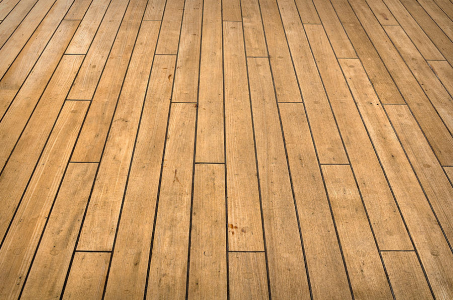

Well, unless there's some color contrast between the treenails' species and the deck planking species, the treenails (or countersink plugs) will be darn near invisible at just about any distance. Can you see the plugs in the photo below?
I agree that "clean" decks often look "too perfect" or "toy-like" on a model. I think most model decks look better with a bit of darker stain and, where possible, given the scale, a bit of unevenness of color. A light wash often works well on a deck. When the slight darkening effect of scale viewing distance on color is overlooked, the result is often a deck that looks too "light." A bit of judicious (and restrained) weathering is usually in order to get a realistic deck at scale viewing distances. Keep in mind also that deck "sheet" material, usually a sheet of plywood or thin flat stock with seams cut or laser-etched into it, can end up looking absolutely awful if the grain and figuring of the piece is itself grossly out of scale, spanning multiple planks. For this reason, individual planking, tedious as it is, generally yields the more realistic deck.
I like the staining on the deck timbers, so what would be used on the deck wood to get this type of look?
BTW I can just see the plugs but not all of them. Is this a real wooden ship's deck? Bob,

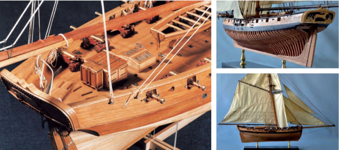

The referenced model of Le Cerf is, as far as I know, the only one of her builds which she describes as a "scratch build." While really of no relevance to the present issue of nails, it should be noted that many "purists' would hesitate to call this build "from scratch." It is a build which follows the excellent Ancre monograph,
MONOGRAPHIE DU CERF - Cotre - 1778 (CUTTER LE CERF BUILD BY DENYS 1779-1780 A MONOGRAPH with eleven plates at 1:48 scale) written by Jean BOUDRIOT & Hubert BERTI. The monograph contains detailed instructions and scale patterns for cutting out all the parts, even down to the jogged faces of the frames which accommodate the lapped planks. From the looks of Ohla's video, she also had the benefit of a digital copy of all the parts suitable for driving a laser-cutter which produced all the parts in laser-cut form from the raw stock she provided. Thus, for all intents and purposes, it was a "digital" kit, not really an original scratch-built model researched and engineered by Ohla. This is not to say that (after a bit of a rough start) she hasn't done a high-quality job building it.
The planking on this model is lapstrake or "clinker," as some call it. The planks overlap one another, rather than being hung edge to edge. It is not uncommon in full-size practice to drive nails through the overlapping lapstrake planks, leaving the heads proud of the outboard face of the plank and clinched (points bent over) inboard or, alternately, to set rivets with the heads outboard proud of the plank face and headed over a rove ("washer") inboard. This is commonly seen in small clinker craft, as well as larger vessels such as the classic "Viking" longboats. Such fastenings, where they may be visible at scale viewing distance, are not inappropriate, of course. However, in this particular instance, if the Ancre photos of a completed model from the monograph are any indication, the hull planking was fastened with wooden plugged countersunk fasteners or treenails which are not visible at scale viewing distance even if the model is finished "bright' (without an opaque coating hiding the natural appearance of the wood.) Boudriot and Berti are a couple of the "gods" of modern scale ship modeling, so I'm going to presume that they were correct and Olha's presentation of black nail heads all over her hull planking is incorrect. Perhaps she's been "brainwashed" by her extensive history of kit assembling to appreciate such "faux detail" and just got carried away with it this time. I don't know. Such things happen. I recently saw a beautifully done lapstrake ship's boat built by one of my favorite master scale modelers who, absent mindedly perhaps, showed all the planking rivets with amazingly small headed shanks over scale roves. It was one of those things that takes your breath away to look at... except in this case, he's put the rivets in backwards with the rivets driven from the inside of the hull and the roves on the outboard face of the planks. As the saying goes, " **it happens." (On one of my first serious models, at 1:96 scale, all the deadeyes are upside down. :rolleyes: )
From all indications, Olha did a beautiful job on her Le Cerf, and to tell the truth, I'd never have noticed her faux pas and ever mentioned it if you hadn't brought it up! ROTF The moral of the story is that don't go by Ohla on this one! :D
Below: Ancre's prototype model. No nails!

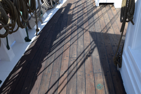

For English ships, when securing deck planking in the 17th and 16th centuries, they used metal spikes, usually iron, but according to Peter Goodwin, once they were driven home they were covered with wooden plugs, not tar or other sealants. I would not be surprised if they were covered with other media on some ship but I have not found an information based on contemporary sources about anything other than wooden plugs. I do not like to use the words never, always, only, etc for ships in the age of sail due to the many exceptions/variations tried but you will not be wrong to use wooden treenails as the exposed part will look like a round 1.5" diameter (0.8mm for 1:48, 0.6mm for 1:64, or 0.4mm for 1:96)wooden cover over the would be spikes. Tar or similar would not look like any contemporary model of English warships in the 17th and 18th centuries that I have seen, but maybe some member has photos of an exception
Allan.

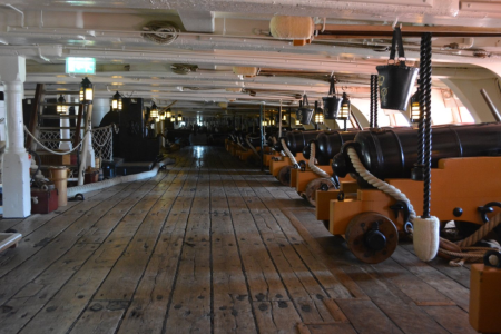

While Victory is a modern ship now with fiber glass cannon and such, if they were true to reconstruction, you can see the wooden plugs rather than tar or other sealants. Tar and feet would be a mess on hot days.

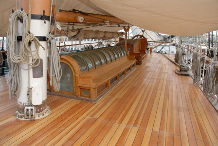

Also! Deck planking must be flush. In other words, nothing protruding that a sailor might trip over, on a dark night.
A plug driven into a hole is easily cut with a chisel flush with the surrounding deck structure because as Bob says, one is cutting with the grain.
If a treenail is driven into a hole, it would be much harder to trim truly flush as one is trying to cut across the grain.
In high quality boatbuilding the idea is to hide the fasteners.

(Below) Treenails, likely locust in oak. Note contrasting wood species color.
(Below) Likely metal fasteners plugged with a darker wooden plug, or possibly treenails, although these appear to be somewhat too thin for treenails. Note plugs or treenails standing proud forward of the corner of the deckhouse in the lower righthand corner of the photo.
